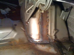

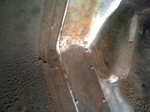

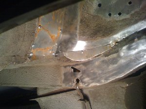

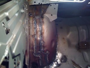

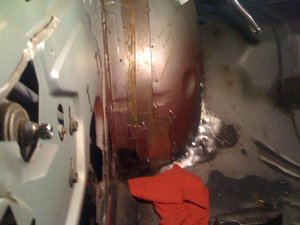

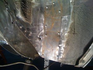

Pictures of where I am at so far. This is ruffed in I still need to tap the metal around a bit before I weld it off. I will be welding the inner tub to the floor in the trunk area and then again in the wheel well along the frame rail. I will grind the frame rail area as flat as possible after welding.
I didn't need to patch the floor at all.

Lookin good!The second side is always easier,you learn an easier wayfrom the first side.LOL.I still have to fixup my trunk lid so it will open and stay up on it,s own.
It is getting there. Alot of work and not enough time, you know the deal! A few hours here and there and bammmmmmmmm it's done! haaaaaaaaa
I pick up my Housing and Axles this week so hopefully I will have some pictures of it on the ground very soon!
Looking awesome. The screws holding the patch metal in place is genious. I should have done that.

Self tapping sheet metal screws, or Cliko pins they all leave the same size hole except screws dont cost $5 ea.
Your work is looking good, keep it up.
Andrew
I have always used self tapping sheet metal screws for metal work. I drill a 1/8 hole in the panel Im fastening to,and punch a 1/4 hole in the replacement metal. This gives adjustment room for alignment.Cleko might be nice but too much money compared to a simple screw!

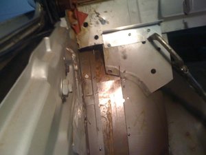

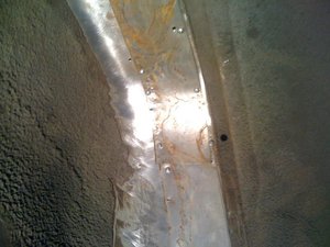

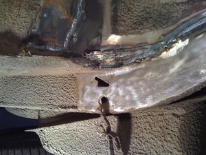

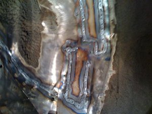

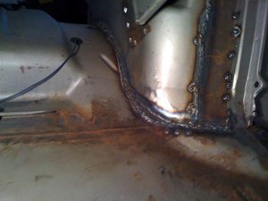

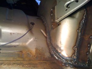

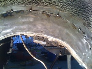

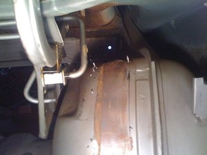

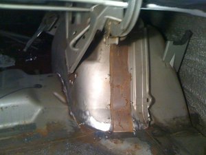

I started welding off the Passenger side this morning. You actually need to be a contortionist to get it done. I worked on it for about 3 hours and I still got about 1 1/2 hours left to finish it. I am sooooo out of shape, in some positions I felt like I was going to POP a LUNG with my RIBS trying to weld it off DANGGGGG.........haaaaaaaa:-D
I will take alot more pics, didn't have time today I was in a hurry to get to work.
Pics from today.
This is a big job it actually looks a lot easier than it is from pics and the power point. Still got about 1 1/2 hours of contortionist welding work left.

Looks like you have to be a contortionist just to take the pics LOL be careful and more pics PLEASE lol love the job so far.

Whoa, are you doing all that with the fuel tank in?
Brave man.
The tank is all sealed and it has 16 gallons of gas in it. If I thought I was going to burn through it or get it hot I would have took it out. Well I guess I will need to take it out on the Drivers Side cause it will be in the way! Damnnn

Almost done!After you get the rear in,it,s time for the cage!WooHoo,can,t you just wait!LOL.I was lucky to do this over the winter and had time to give my body a break.Yes,getting old!8):clock:
