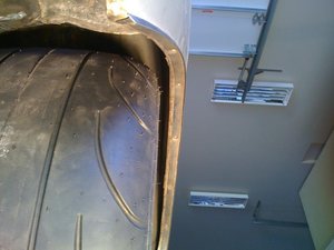

1" clearance on each side? That is a ton. I have about 1/2" on each side and have zero rubbing.
My 70 Dart is about 3/8 away from the LIP of the fender and it is NOT rolled either. I have never rubbed! Stay on the gas and the tire gets Taller! haaaaaaaaa:-D

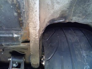

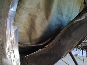

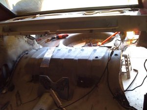

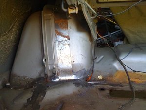

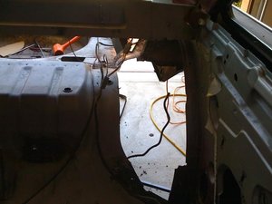

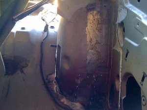

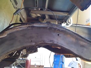

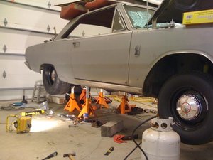

Put a couple hours in today. I got the Drivers side cut out and tacked back in. I just need to weld it off. This side went ALOT faster than the Passenger side did for sure!

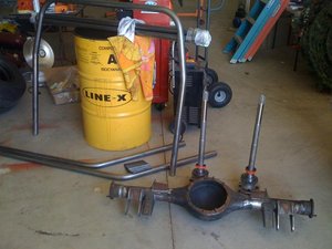

I talked to Sutton Engineering today and Ed's Flash Burn is healed up, he told me to pick my housing and axles up on Wednesday.
The Roll Bar also gets delivered tomorrow..............................

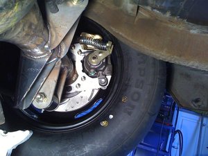

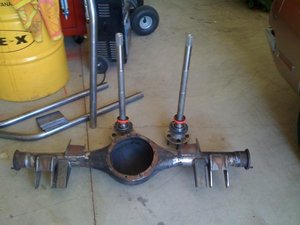

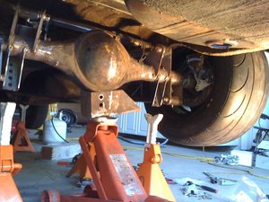

Ok the Roll bar showed up yesterday and I picked up my Housing from Sutton Engineering this morning along with the axles that were shortened and re-splined with new green bearings. I also had him install 3" Studs.
I am going to mock it up 1 more time to install the brake line clips and to make sure it all fits like planned. I will be taking it apart and sending the housing, brake brackets and Link Bars in for black powder coat. I will attempt to finish off the roll bar while those parts are getting coated.

James you got that SICKKKKK DANA under yours! If I didn't already have the brand new Nodular 489 Case with 3.91 gears, new suregrip and 7290 pinion yoke ready to install I would have went DANA for sure! Plus I picked up my housing and axles for $50.00!

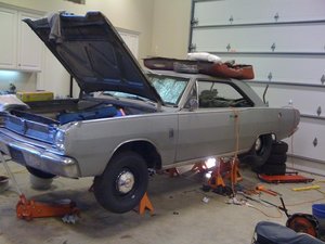

I mounted the rear tires on my Dart for the first time last night, OMG it looks BAAAAADDD!! I will get some pics soon. I also installed the front end, and I'll get some shots of that and put em up in my 70 Dart build thread.

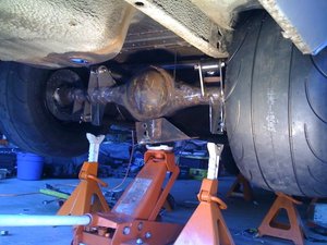

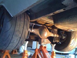

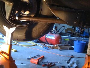

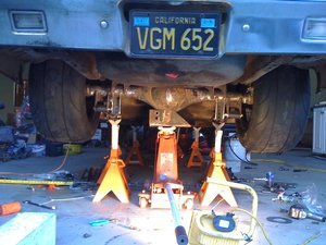

Hey it all fits! My measurements were correct. This is the final mock up before powder coat. I will be ordering my shocks now and fabricating the rear brake lines and welding on the clips to hold them down on the axle. Powder coat is next. I am Happy today seeing what I have built all on my own and it fits perfect!!

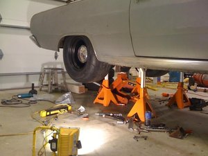

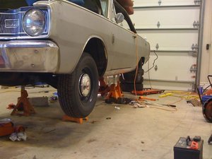

man i wish you could set in on the ground. I would love to see how it sits at ride hight. (i know that its at ride hight now, but its not the same....) looks good man how much room do you think you ahve between the wheel well and the tire? looks like about 1/2-3/4 of an inch if that. that is the look im after on my car.
Well it wil be a few weeks til its on the ground. Shocks and powder coat first. I have right at 1" clearance on each side!
