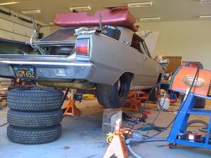

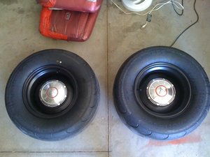

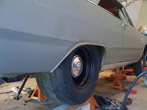

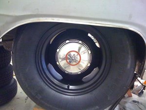

I got the tires mounted this morning.
Just a little more tire than my 70 Dart has! Where the heck is my housing at?? haaaaaa I still got some fabricating to do and finish up the welding on the Passenger side for the Mini Tub. I am thinking I will be done with the whole Mini Tub before the housing is ready. As soon as I get the housing I will take it in for Powder Coat along with the Link Bars, Link Ends & Brake Brackets which will all be BLACK!

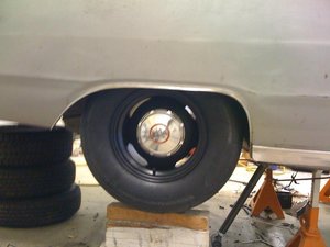

In this picture the Caps look like they are dented but are not. Optical Illusion.

Tires and wheels look great. Oh yeah it is a pain, to jack up the car in order to remove the meats. I will be screwed if I have a flat someday. Where the heck would I put my spare?

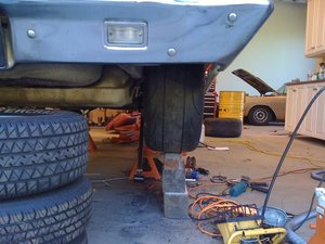

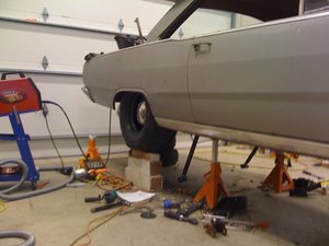

Well, I got 1 side ALL welded off. I just need to hit the welds with a sanding disc and put on some seam sealer.
Here is what the tires should look like.

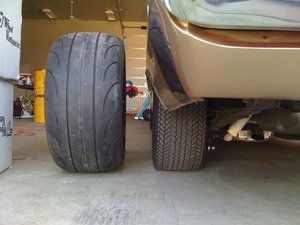

man i hope they stick out just a little more, as they look really close to the frame in your pic.
The housing is not in and they are mocked up crooked. I will have about 1" clearance on each side once it is all put back together. Come on man My Momma didn't raise no PUNK!:-D
yeah yeah yeah......its cool man I was just not seeing much room between the tire and the outer edge of the fender and was just making sure. I'm following your build close because I plan on running a similar setup. I looked on summit racing and foung your wheels and could not find a front narrower than a 6in wheel. What are you going to run up front I was hopeing to be under 4inches wide on the front. I might have to look at a different wheel. But I really like the look of yours.......

Beautiful Wheels and rims mopapdude318 how wide are they actually 12"?
Im wondering when you will mount them? I would like to see how the wheel wells fill out.
