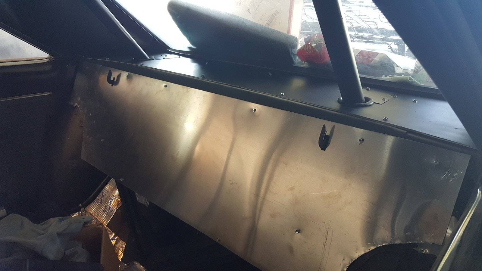

Well finished the package tray all sealed and now starting on the firewall behind the rear seat, just need to mold the lower half so I can still have access to the rear seat belt bolt holes, then I'll get that all sealed as well, just using self tapping screws just in case I need to remove it, but should pass Tech when I race it.

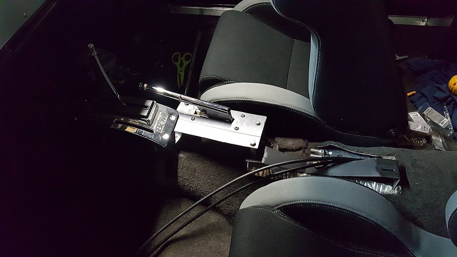

Well did a little of customizing, it's not all that pretty but once the custom console goes over it they will make it look better lol, swapped from the stock e brake handle to a more modern and won't have to worry about hitting my knee. Also finished the firewall behind the rear seat and cut a slot for the middle seat belts.

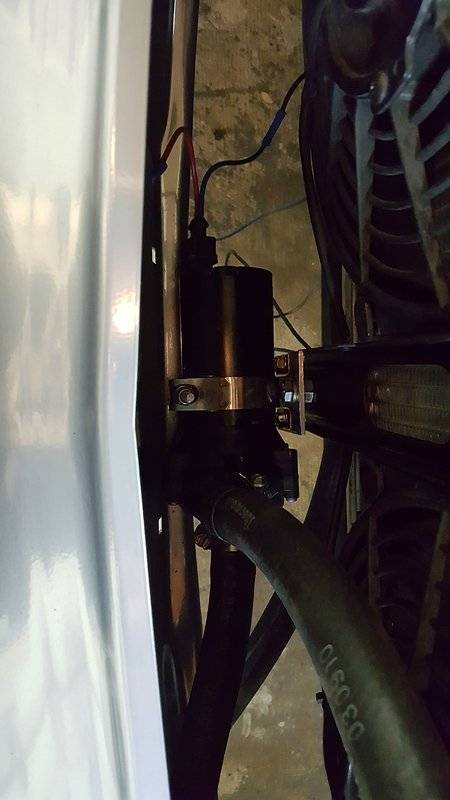

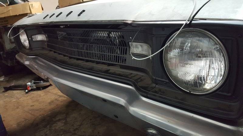

Well got to work on the car some today, had to borrow my front wheel off my 72 satellite so I can mount the front bumper on and then mounted the pump for the intercoolers, and got them in place as well some plumbing done but still just a bit more for the intercoolers, placed the ice box on the inner fender since the exhaust is wrapped.
