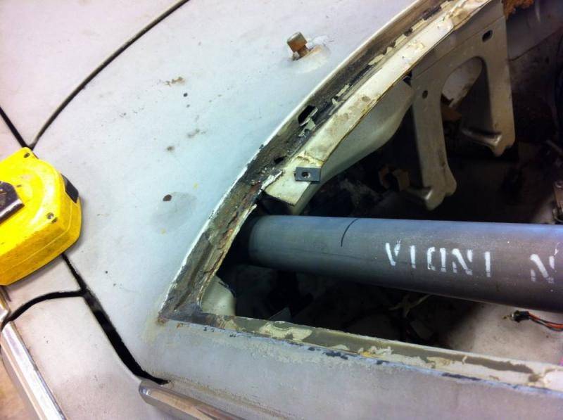

Here you go its from maddarts build thread when he did the cage.
thanks , I bougth tubing last week so ill be starting a cage soon .
Awesome, and good luck, he routed the knee knocker one up higher behind the dash, plenty of knee room.

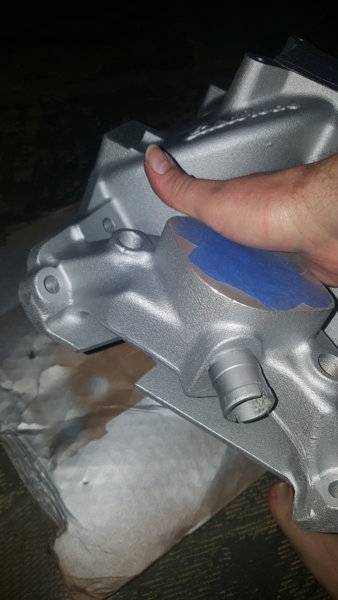

Look what showed up today. Big thanks and appreciation to Michael at B3racing engines for the porting, valve train upgrade, springs locks and keepers, inconel exhaust valves. Just need to check the rod bearings for clearance, can assemble the short block, paint the heads, keeping it aluminum color just protect the raw aluminum, need to grind the intake a bit to clear the priority main feed fitting. Flow numbers are in another post prior to this post.

Got the pistons installed, mounted the heads to check where I need to grind for the priority main feed, but turns out I need a double thickness intake gasket, due to the 9.6 deck I'm guessing. Have an emial out to superformance gaskets to see if they can make one. Painted the heads, kept the aluminum color to them just don't want the raw aluminum which absorbs everything, and painted the front cover. Also side note, needed to get the mopar hv spring kit since having my oil pump gears coated, and just squeezing the two springs the mopar one did feel stiffer over the hv one that comes from melling.
Well found another nerve racking thing to do, had to notch the intake for the priority oiling, also since its a 9.6 deck had to get some double gaskets from superformance, Greg is an awsome guy to deal with, he even bonded them together with some high strength adhesive, and these are new type material, it's not on his website yet, but call and ask for them. Going to order the head gaskets here soon and need to get some gasket material to make my own front China wall gasket
