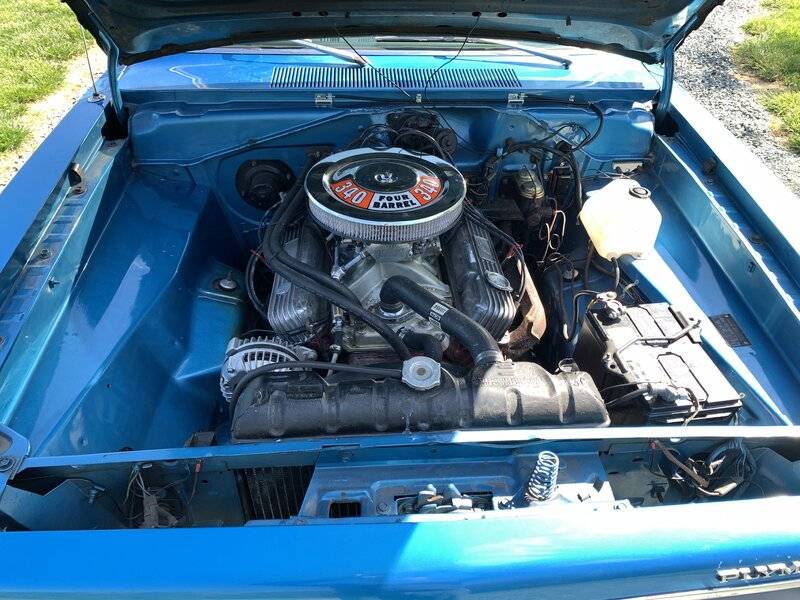

I recently bought is 68 Barracuda 340 formula S car. Some of you may have seen it on craigslist. The car sat in a storage facility for about six years. It’s a solid car and and I got it running after flushing all the fluids.
It seems to be only running on the battery (it cuts off if I unhook the battery while running). I’m not getting 12 V out of the field tab on the alternator, I’m getting 0 and only getting 11.4 on the larger post on the alternator. I’m getting 12.3 volts at the battery. I’ve installed two alternators after I realize the alternator which came on the car was no good. I’ve change the voltage regulator. I’ve replaced the battery, and cleaned every electrical contact and wire point between the alternator and the battery. A couple of questions:
1- could I have gotten 2 bad alternators from Autozone? I will try a third one from them and have them test it before I leave the store with it. The fact that I’m not getting 12 V out of the “field” tab indicates to me that the alternator is no good.
2-I should be getting about 14v at the battery terminals right? That would be the alt charging it.
3- I do not see a ground strap from the block to the frame. Is there supposed to be one and if so where? The negative battery cable is grounded on the block/head and was cleaned and reinstalled.
Thanks folks
Rusty

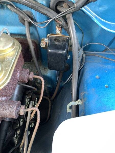

I neglected to state that I grinded paint off the engine bay behind the Voltage Red, the ceramic resistor and the little component next to the battery... is that a solenoid?

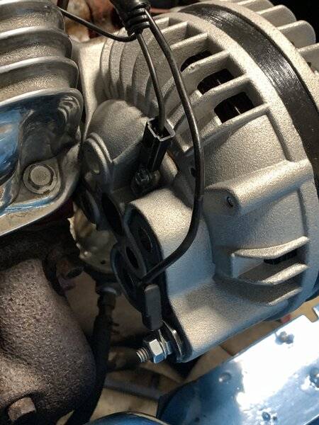

Here’s a pic. Any idea where I could find a correct alternator quickly ?
Bad picture not showing all the terminals. Assuming that you have the original single wire field. You have one smaller wire going to the field (actually a brush), and on the opposite side the brush is grounded to the case (no wire). While running, go to your VR with a jump wire and jump it's two terminals, bypassing it, and forcing maximum output. How much is it charging now?
If there is no connection to one field terminal, All you have to do is run a wire from that field connector to ground and it will work fine. It doesn’t matter which one is grounded. The 69 back ones are supposed to have that done.
You can ground it to a bolt on the alternator.
You may also be able to ground it by removing an insulator from the brush holder so the mounting screw grounds it. If you google it you will probably find some images.
That alternator should work.
If both brushes are insulated and have tab terminals, ground one of them.

Hey there and thanks.
The back of the Alts I’m getting has a post with a nut and 2 field tabs. I’m not quite sure I understand your question. If there are two tabs one of them gets grounded and the other one has a plug and which runs back to the firewall and towards the voltage regulator?
If I’m understanding your directions correctly I should run a ground wire from one of the tabs to sheet-metal somewhere?
Yep, you can actually just ground one of the tabs to the alternator case easily. As Mattax said, there is a nice picture in post 3 of the modifications. The last picture.
