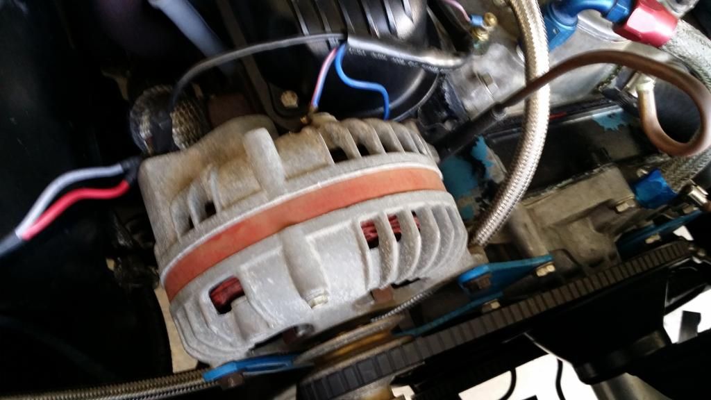

Car was operating fine, but now does not charge battery.

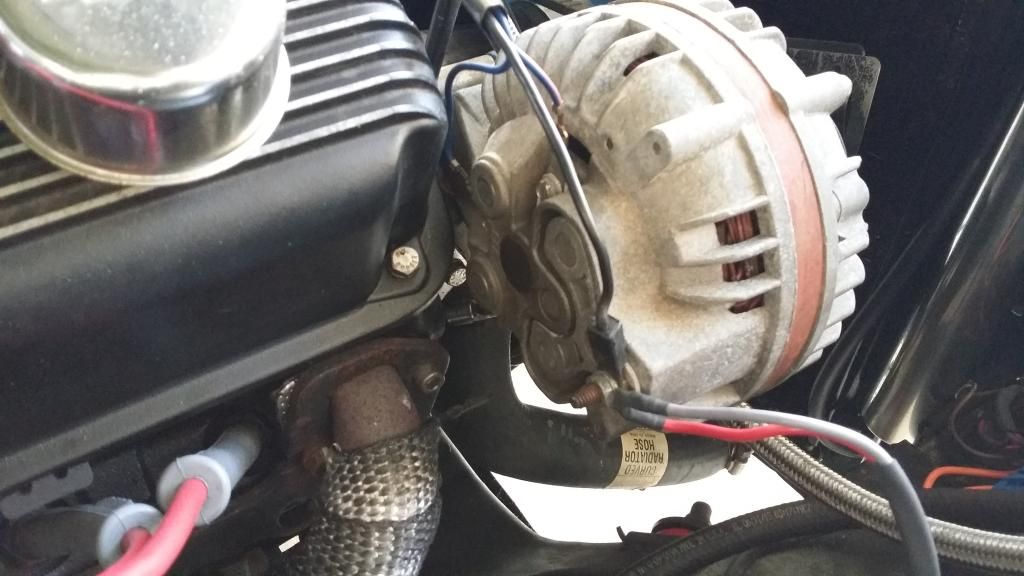

3 wires coming off alternator. 2 Have voltage when car is running. 3rd has voltage when lights are on. "Using crackedbacks wiring mod if that makes a difference"

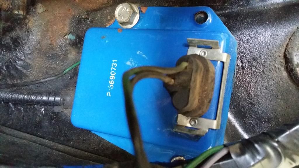

2. Voltage regulator on firewall test ok.

Grey and black are part of crackedback's wire mod and have voltage when headlights are on. . 2 wires to the right have voltage while car is running.

I tested the wire going and and out of the regulator while the car was running and found voltage on both sides. It's loose now but seems like it was grounded to the firewall. I cleaned up the mating surface. There is a wire coming out of the firewall that end about 4" after exiting. No idea what that is/was supposed to go to.

The voltage coming out of the 2 wires in the VR connector....was that very near to 12 volts? If so, then that is normal with the VR unplugged. one or the leads feeds the 12v to run the VR, and the other is the connection to the one side of the alternator's field winding. If I understand your readings, they show that the alternator's field is basically OK.
Also check the terminals up inside the VR connector see if they are clean and not spread out; these can have poor contact at times.
The next test should be to measure the voltage of both of the small terminals on the back of the alternator when things are running and everything connected; just be careful with yourself and the voltmeter leads with the belts and pulley! Have the VM - (black) lead connected to a good ground. (These 2 wires look to be blue and blue/white....is that right?) One should have close to 12v and the other should be lower. Report back the actual voltages that you measure (as in 12.1v or 6.3v).

I'll double check the voltage of the 2 small terminals on the back of the alternator. Both were in the 11.5 - 12v range if I remember correctly. Wires are blue and blue/pink but this car has been gone through prior to my ownership. I don't think one side was lower. The larger connector that the headlight kit is connected to had zero voltage until the headlights switch was turned on.
Checked the 2 smaller terminals. Both read the same 10.4v

The VR MUST be grounded.

The VR may have lost ground
The VR connector may be internally broken or corroded.

Is there supposed to be a grounding wire at the VR or does it just ground to the firewall? Mine was made with a plastic coating but I don't see where a wire would connect. Other than a small corner of the plastic that has peeled off and the bolt holes I'm not seeing how it would be grounded.

Did you check the 2 wires on the back of the alternator with the engine running? If so, then there should be some difference in voltage between the 2 terminals, if the voltages are the same, then the VR is not pulling current through the field like it should.
The VR case normally grounds to the bodywork through the bolts; star washers under the bolt heads will help. You can add a ground lead if you like but the case must be grounded for the VR to work. That could explain the 'no voltage difference' on the 2 smaller alternator terminals.
