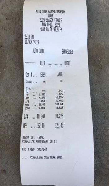

Second time run on Saturday...looks at time slip ans sees 10.84....car in left lanes time...thought it was hers...and then see 10.27....lol...
