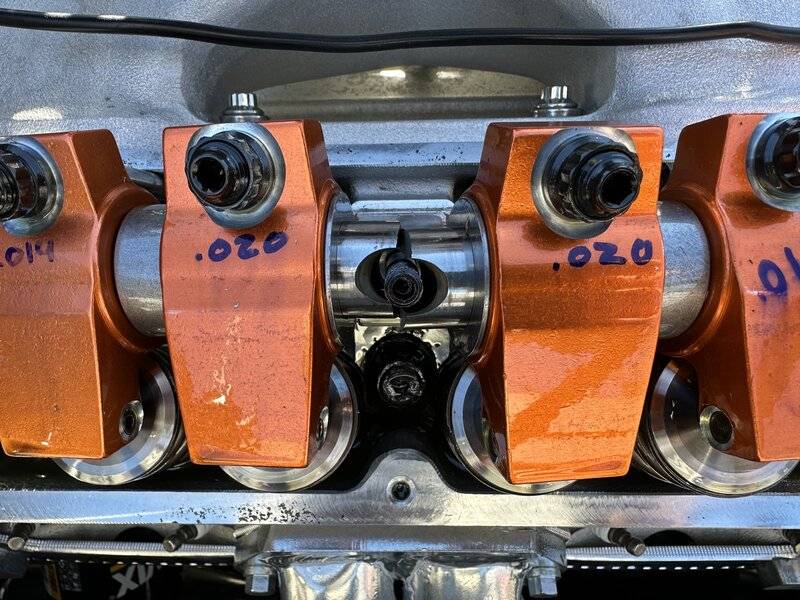

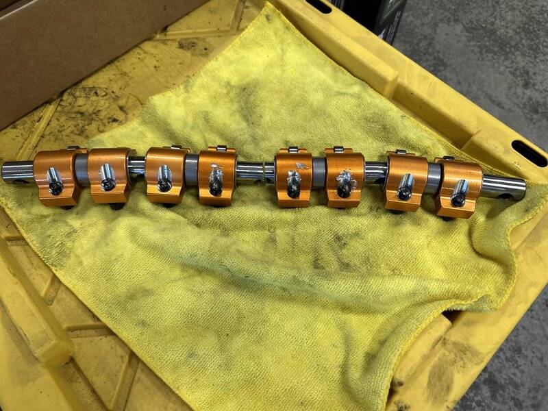

Well ****…. That didn’t last long. Took it for a drive today to heat cycle the gears. When it picked up a slight miss around the corner from home so I headed back. As soon as I pulled in front of the shop, I heard a loud bang and it really started miss firing and I shut it off. Checked all the normal stuff and everything looked good until I pulled the valve covers. Looks like a nut backed off a rocker shaft stud and the shard snapped. So far what I have found to be damaged is the rocker shaft (obviously), 2 rocker arms and 1 pushrod. Found the keeper, nut and washer in the valve cover. I’m contemplating pulling the engine and doing a complete reason just so I can have a piece of mind knowing there isn’t any shrapnel somewhere.
What pisses me off more than anything is still no burnouts. In fact, I was only on my 2nd heat cycle so I haven’t gotten after it yet. Probably a good thing as I’m certain the carnage would have been worse at high rpm’s.
Oh ****, that fuckin sucks.
I broke 2 rocker shafts from harland sharp already.
Yes that pisses me off for you
Damn, that's a shame. I have been fortunate of that to not happen to me on any of the group of cars that I have my hands on. Hopefully it's nothing major.
Hope its nothing major, but being it happened without much running makes me wonder if it was a weak part, or something go over looked during assembly.
My initial thoughts are that the nut backed off the stud due to not being torque properly or the threads got ripped out of the nut or stud (part failure). I’ll know more after I inspect everything later today.
What a sad sight…. lol
The nut definitely backed off causing the carnage. In fact, that entire bank wasn’t fully torqued. Damage so far is 3 rockers, 4 adjusters, 4 pushrods and of course the rocker shaft. Won’t know more until I tear the engine apart and check everything else.
Here’s the good news…. I called Harland Sharp and explained what happened, including the fact that the nut backed off the stud triggering the carnage. They told me to box everything up and they will take care of me with the parts to get me going again. Talk about amazing customer service, especially with it not even being their part that caused the failure! They have earned a customer for life!
