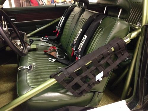

And you may have blown the sleeper looks thing. Nice job getting the crotch straps integrated with the bench seat.
