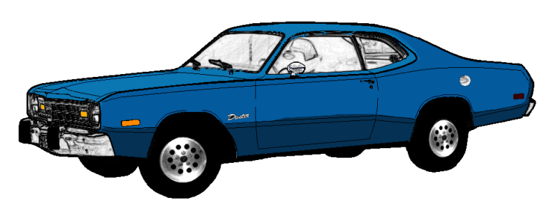

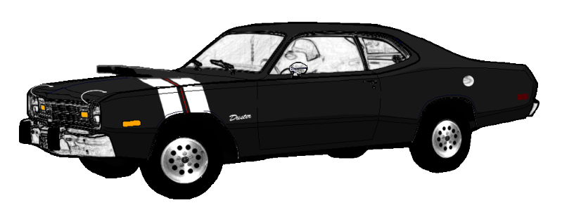

Finally summer! About two weeks, and I'll have my first full paycheck of the summer, meaning I'll have cash to work on the Duster. I've been so stoked. Made a bunch of spread sheets with things I need and where to get them, timelines, and this! It's a concept I had been toying with in my head, but I wanted to SEE it, since I hadn't ever seen the scheme on a Duster before. So, when I was finished, I decided I was pleased, and would see what the wonderful people of FABO thought!
I've always loved the GTX stripes, and to me, they match the angular body so well.
Special thanks to J-MacsMopars for the lineart.
i like the stripes. that is definitely one idea i have never seen on an A body and it works. keep the pics coming Sully. have you decided what color yet? looks great, im watching this one!
At the moment, we're thinking black, as in the picture. With me and the wife though, there's no telling by the time we order paint haha. Black is one that we keep coming back to though, and I'm really liking the ones I see pictured in black, and this mockup, so there's a strong chance we'll stay with it.

Nah. I don't think I'll be putting a top back on with this incarnation. Pretty sure we're going with the black. Looks clean and sleek. Tried to get the wife to consider the "tank tread" variant, but she just wasn't a fan haha. So these will likely be the stripes.
I like the stripe idea. Should come out looking sharp. Maybe it's just the picture but I would lower that front end a little. Keep up the good work.:coffee2:
It's just the picture. I was using lineart from J-MacsMopars. It also doesn't have the window louvers I hope to have for it.

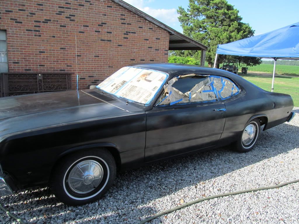

Painting began yesterday, and will continue throughout the week.
Yeah. We may not know what we're doing.

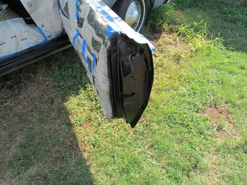

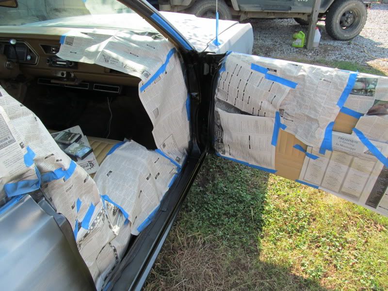

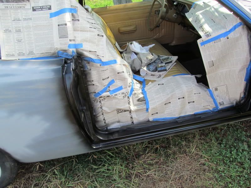

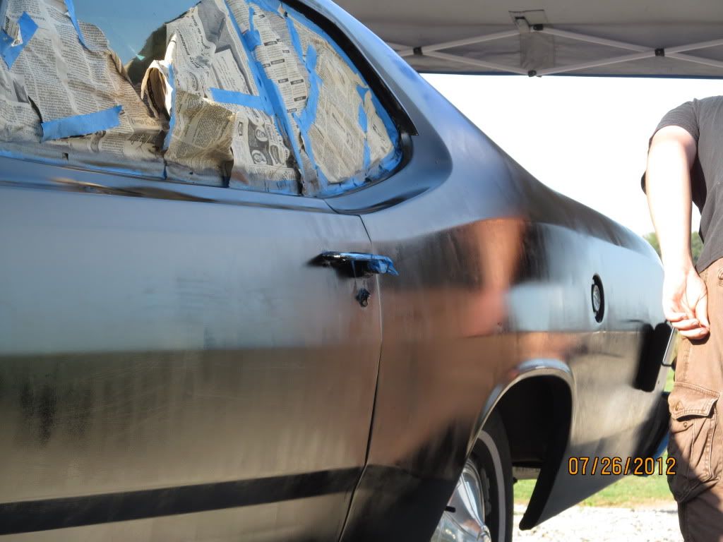

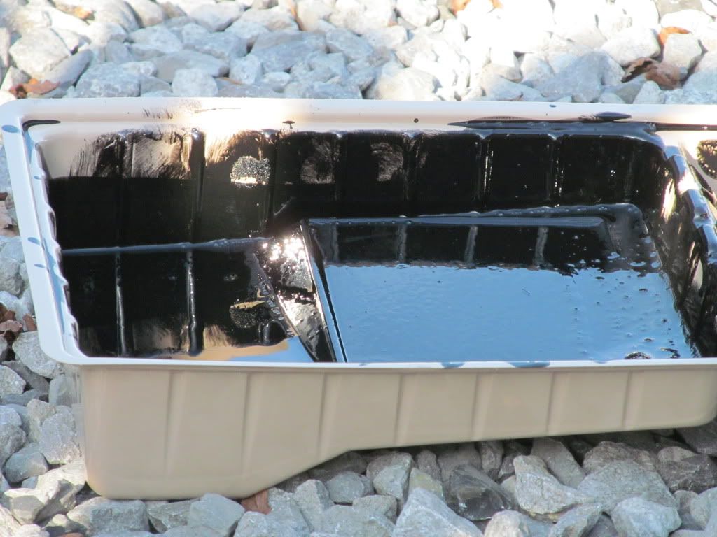

Quick shot I took this morning. The dew makes it look odd. Anyways, got a full coating on last night, using the roller method. I'm not going to lie. Applying it yesterday afternoon, it looked rough. But this morning it was really smooth. I was /highly/ impressed. Today will be wet sanding, spray painting around areas that can't be rolled, and applying another layer! Now that I've learned how, it's really not that tricky.

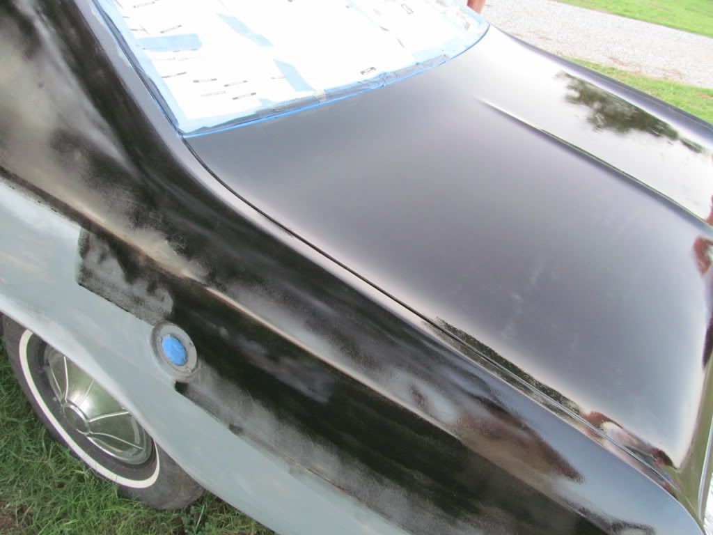

Here we go. Backtracking a bit, but finally got /some/ pictures online. So I'll post the highlights of what I have.

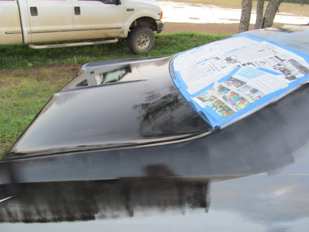

As you can see the paint smooths itself out really well.
These were the next day; post sanding.

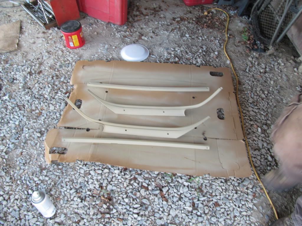

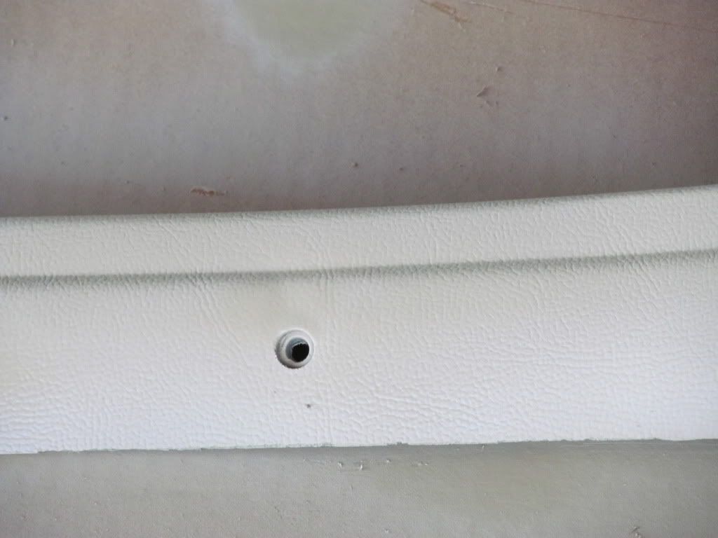

Painted the interior pieces I got in. God. You have just got to love FABO's classifieds.

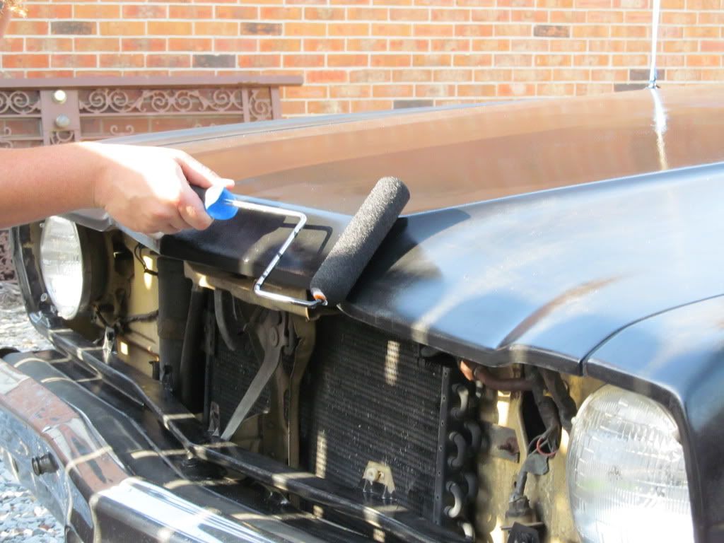

Coat two. You can see that the layers are really transluscent. You're barely applying any paint at all using this method. And please, PLEASE, don't just try to pile more on. You have to go very thin, very diluted layers. All of the layers we rolled on were cut 50/50, and you can't just dunk your roller in it. You have to wet one side, and then spread it around on the flat part of the tray till your roller is covered. After that, you roll it onto the car, pressing down firmly, then roll back over lightly with only the roller weight to smooth it out. You can work the paint like this (with only the roller weight) for just a little while. So make sure you move quickly to get it right.
More shots. The paint holds bubbles easily. The "light rolling" helps take these out.

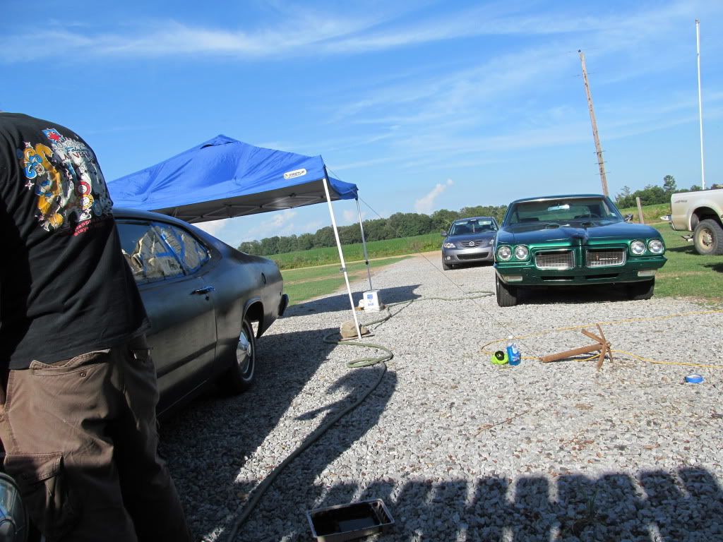

My parent's lemans in the background.
We've done more than this on it. We've wetsanded it two more. Put several more coats, and sprayed on a coat, however, those pictures still aren't uploaded yet. (I had to threaten my brother just to get these.)
It has a lot of dents and dings and imperfections that I couldn't see before painting it, but I think it's going to still turn out alright. Current paint is smooth and sleek, but too thin in a place or two when you get it into the sun, so we're going to spray another coat or two. It's by no means a show-quality paint job, but that's not what I'm going for anyways, so, it'll be fine. It's great for a daily driver though. Maybe in a couple of years I can fix those problems in the body and paint it again. ;)
