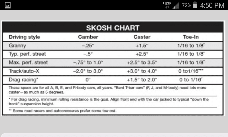

I didn't see anyone post this, i saved it from a recent post, I believe it is specs preferred for radial tires on car the were not equipped with them. Someone else will probably verify exactly what it is. Good luck.

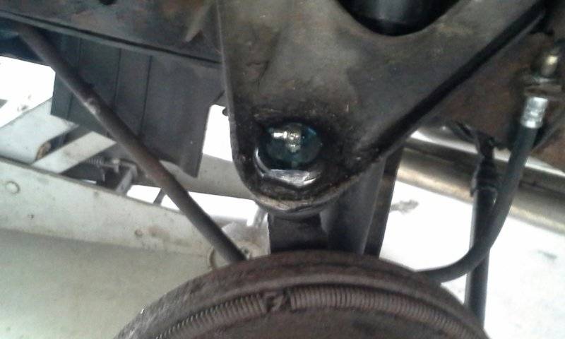

Those hammer marks on the upper control arm lip?
Someone didnt know they threaded in.
The weld is a little bigger than i would have done,but thats my opinion. Only way it could rub is if its installed crooked.
Its where the rim rubbed the metal away on the control arm and the ball joint edge. Its a 16 mile trip home from the shop. I've since made a spacer for the trip to the shop. Owner agreed to take a look and see what he could do. Appointment tomorrow.

A 14x7 with a 4.25" backspace shouldn't be rubbing that badly on the ball joints. That's a little more backspace than what you would normally see on a 14 SBP drum brake wheel, but not a ton. And that wasn't a minor rub, that was hitting pretty significantly.

-.25 degrees of camber isn't going to wear anything. Camber is a wearing angle, but not until you go past about 1* in either direction. A negative 1/4 of a degree is a very conservative alignment for a radial tire that won't wear a thing.
Do they have the old ball joint at the shop? It may have been ground down to clear the wheel by the previous owner. Did they rotate the wheels while it was there? The back wheels may have a different offset... I don’t think this will be to difficult for shop to figure out, I don’t see how that ball joint could be installed much differently unless it is not screwed in all the way.
That's Rick Ehrenberg's chart from a Mopar Action Magazine issue a few years back.
