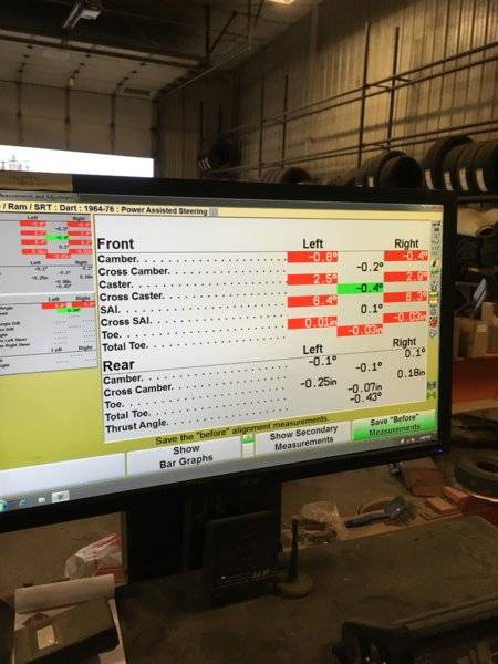

Alignment issues yet again
Those numbers aren’t that bad. I would expect another degree or so on the caster with the offset bushings, but ride height, both front and rear, as well as the rake, can make a big difference.
Did you do anything other than change the strut rod bushings?
A couple of the cam adjuster washers had some play. I was going to replace them but couldn’t find ones without the double flat spots.
Welded/filed the old ones.
Run it.
2.5 to 3 degrees positive caster with just offset UCA bushings.
Take the $200-300 for tubular UCA’s and buy a front sway bar or 1” torsion bars.

Were there other changes since the last time you drove it ? ?
Torsion bars, bushings, shocks ball joints, etc....???
The torsion bars were installed previously. The only thing that was replaced were the strut rod bushings. raised the ride height and welded up the cam washers.
Drives awesome after the 8th alignment try. Not sure what was wrong/changed.
