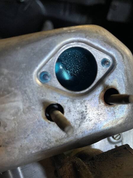

When you installed the integral regulated alternator, what/ how did you do/ wire up the green and blue field wires off the old one? I'm thinking THAT is the start of the problem

what’s the story on them post in the second to last pic posted? looks like they are touching the housing
