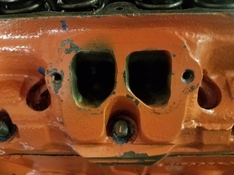

I have a set on my stroker. have not ran it yet. The PO did some bowl blending and tried to polish the intake port, not sure if he helped them or hurt them. I didnt know if they were a performance head, thought it was just a '308' replacement version. wasnt alot of info on them last time I looked...5-6 years ago.
Nope, my mistake, they are 974's hogged out. Not much of a short side radius on these exhaust ports....PO gutted the floor! Pretty rough port match too. I didnt touch these, just got these 2.02's for a song.
There’s proof that everyone should not touch porting burrs. I think we have all done some type of porting work we shouldn’t have but he hit every base on that job.
I got a pro ported set to replace these. Much cleaner. This was a hack job I agree. I think he was under the impression that the bigger the volume of the port the better it would flow. We know better, shape and flow is where its at. One of you porters should mark up the errors in this hack job and make it a sticky on what NOT to do when porting. You got my permission to repost and flame it as I take NO credit for doing this, only buying them for $100 a pair as the 2.02 valves and dampered springs were worth that much.

Whatever you do, do not make the exhaust port bigger. It’s too big to start with and the shape is horrible. Take the bump out of the roof, and remove the smog bump if there is one and do your best to get something like a radius on the short turn.
