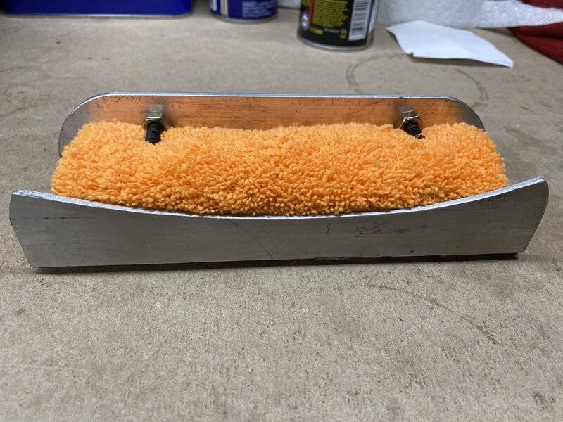

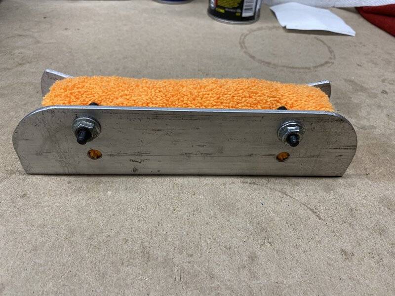

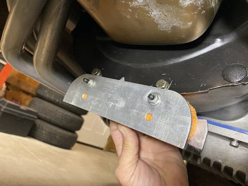

Here’s a temporary (or permanent hack) to soak up the leakage while you hem and haw as to whether you want to tear it all apart. I made this diaper holding thingamabob to bolt into the bottom two inspection cover holes. I used two maxi-pads (for heavy days) :eek: I found in the bathroom and packed them (orange towel shown for reference) into the aluminum angles that I whittled together that bolts in place. I had a good drip from the front seal and put off fixing things correctly. I put on about 600 miles or so before I needed to change out the tampons. Don’t laugh, :rofl:as it worked and I got to run at the track a few times :steering:before I finally decided it was time to fix things.:)
Yeah, it’s a keeper!
