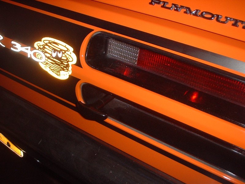

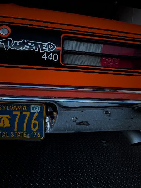

Push/pull thru the rear panel on one car, one in place of the gas filler in the rear panel, and one in a drilled hole, along with a pair of charging terminals.
And the last also has a concealed switch in the passenger compartment as well.
All three on the right rear of the car.
I put the Volt decal on a magnetic strip and would install it when they wanted it on at the track. When pushed in ti was not noticeable. I believe I bought it all from S&W racing or Mancini racing
That’s nice you can barely see it. You drilled through the light?

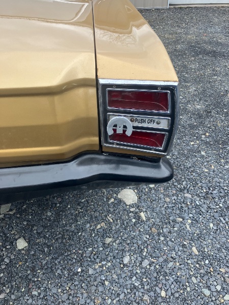

Location on my Dart. I had a T handle for years , a friend made me the “ M “ for it a few months ago . I made a plate to cover the back up light and put the shut off rod thru it , its a Moroso shut off switch assembly. Charging lugs are mounted on a plate below the shut off switch behind the bumper , out of sight but readily accessible.
