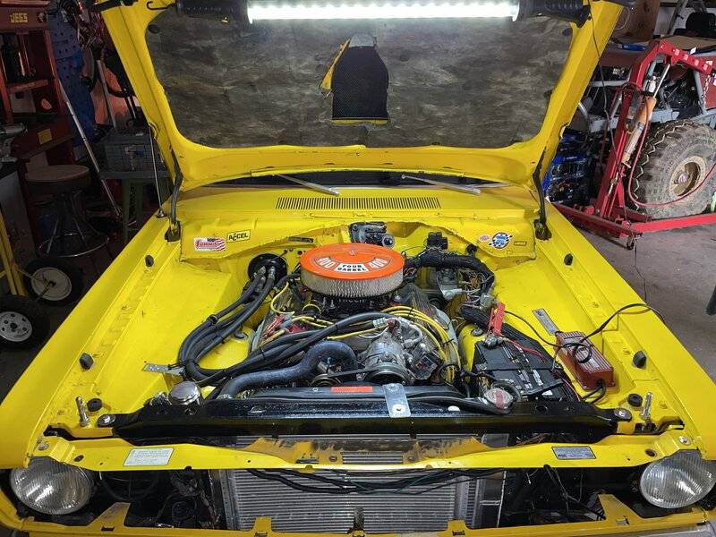

I have a Chrysler 400 from a 1973 Plymouth Satellite in my 70 duster. I bought the car with the engine already in it.
While testing the other day I noticed that the temp was about 200-215 on the top of the heads. About 145 at the TOP of the radiator at the hose and about 194 at the BOTTOM of the radiator at the hose. All was done with my temp gun. The car has a sending unit in the stock location and it reads about 20 degree higher than the one in the radiator itself.
question : if the flow is normally bottom to top, this doesn't add up. I believe I am using a stock pump housing and a high flow standard rotation pump.
should temps be lower at the bottom of the radiator?

Just noticed you have a cross flow rad, that might help explain the odd seeming measurements.
Air in the system can cause everything you describe.
That upper rad hose looks tough to get all the air out of?

Depends how the inlet and outlet align, and how fast the water is moving. The upper hose comes into the top of the tank - water could be rushing to the bottom of the tank and going straight across the bottom toward the outlet (to the pump). No idea if the end tanks are baffled, or have any other design features to prevent this kind of flow establishing itself - but it's definitely possible.
I'd be checking all over the core and seeing if you can 'map' the heat - or even get/borrow a thermal camera to see if there's anything to see.
Also, a hole in the thermostat won't bleed all air in all circumstances. That upper 'loop' in the rad hose could be trapping air in the system if it's the high point in the routing. Even without something like that, I often have to massage the rad hoses while filling to force as much air out as I can.

Thanks, good idea. It was low a little from a leak. So I could see pretty good.
it was flowing from upper hose to the other side.
Assuming you mean flowing from passanger side to drivers side.
You said you have a tri flow (IIRC) so it would be from passanger side to drivers, down, then from drivers to passanger, down, then from pass to drivers side to the outlet.
If the outlet is on the passanger side then it is only a dual pass.
