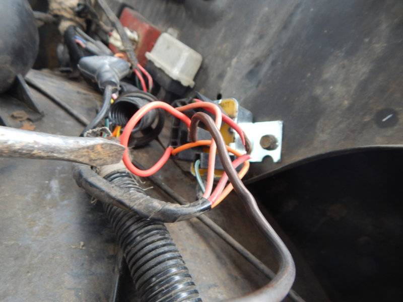

Screw driver is touching the jumper wire. Without this wire, it will not start by the key. With this wire, it starts great with the key. No wires get hot.

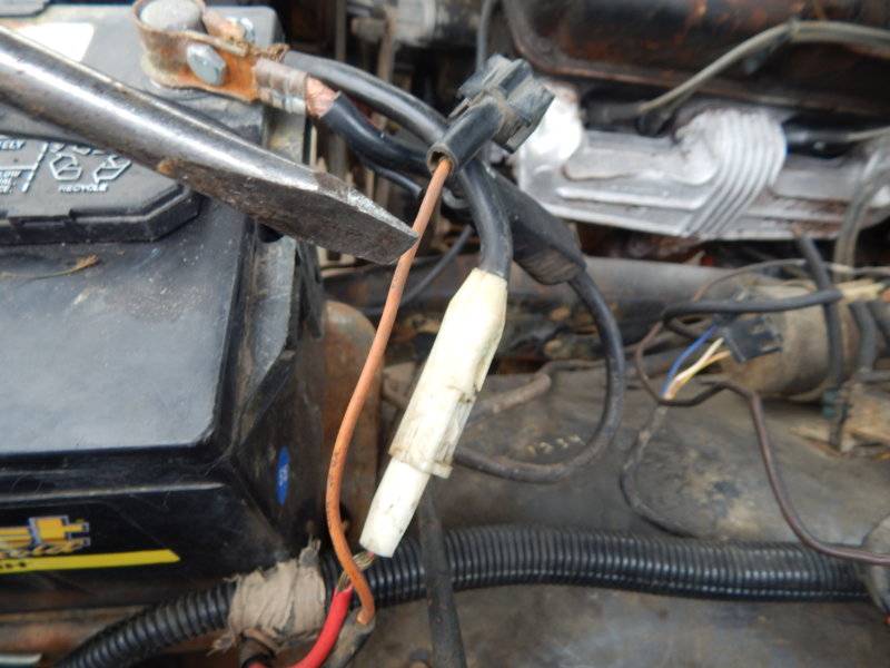

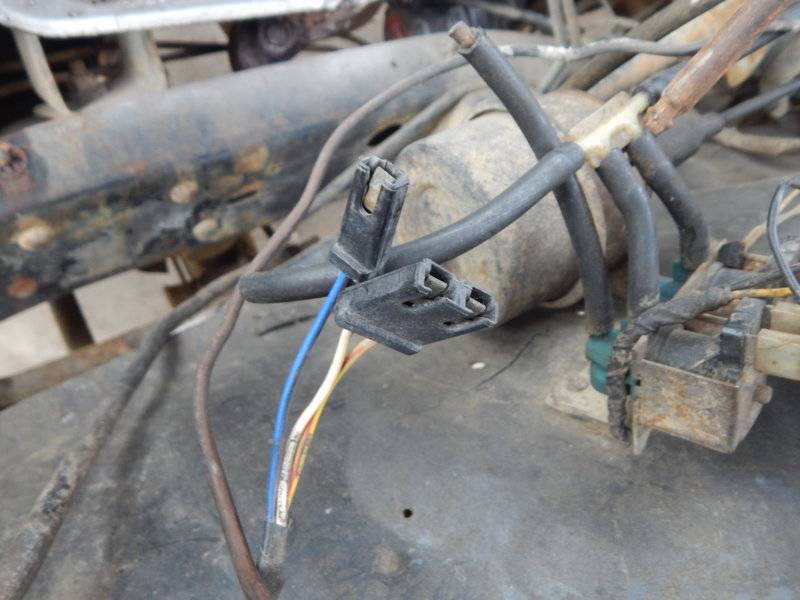

Here are a couple of wire connectors that are homeless. The only one that is of real concern to me is the orange wire up by the battery. It's the same color as the ignition wires, has a fusible link, and seems to be looking for power.
Tape them or zip tie the spares out of the way and drive it like you stoled it.
yeah, that appears to be the plan. Now that it starts by the ignition, and I'm running the electronic ignition system (instead of the points; not that points are bad) as Chrysler made it, I'll move on and see what's going on in the "charging" world.... LOL. If I'm not boiling the battery, life will be good :)
In the second picture, the clip that has the two wires to it, doesn't that go to a cruise control?
It could. The cruise control canister is still there (you can see it in the background of the same picture), but nothing to really hook it up to.
