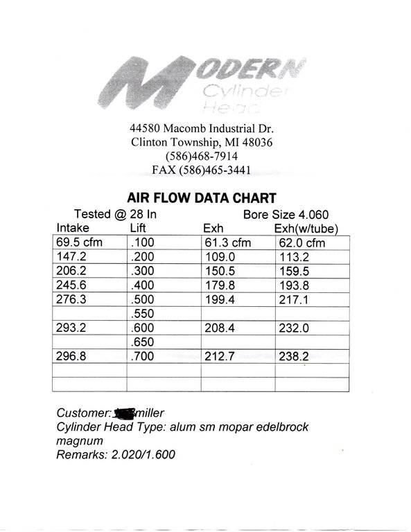

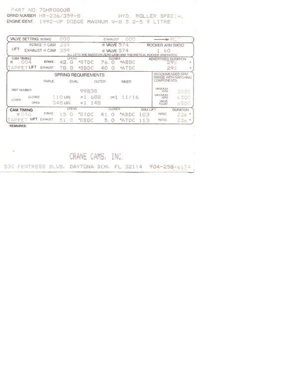

I'm gonna post my build just so people get an idea, I too did an engine dyno and cannot recommend it enough, they break it in and find problems before you do while it's in the car needing to be removed again.
360 -1992 Magnum stroker 408 build
10.25 or 10.50 compression, I don't recall exactly at the moment. Not it makes that big a difference.
Edelbrock performer heads -work done at Modern Cyl Head in Michigan
--see pic attached

The general feel is that this motor will create more HP/TQ with solid lifters and probaby spin at 6300-6500.
Cam card and head flow numbers attached
This car weighs 3290 with me in it, all steel. The goal is a nice street strip car that could turn a number around 11.30ish. Most people feel it will with those power numbers, some feel much quicker, we will see. Caltracks, 4 wheel disc. It should in the least be a very drivable car. Will probably put 3.73 rear gear in it to tame it down if it's too much with 4.10s.
360 Magnum stroker 408 build
--see pic attached
--see pic attached

cam = drane billet steel with iron gear .236 .050 .574lift 110LS, 1.6 rocker ratio

The flow chart shows why most heads don't need a dual pattern cam.
