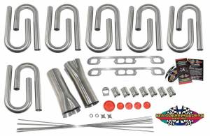

great timing. Lol I was looking up weld up header kits and came across this company. What do you all think about them? Has anybody user them before? This was a list I was playing around with. So I haven't bought anything yet.
Yeah looks nice, I just can’t get over the price.
Look at it this way. If you can do the work and welding, it is very close in price to a raw mild steel header from TTI in 1 7/8" tubes. I have had the same TTI steel headers, that were originally chrome plated on the outside, on my car since the early 2000s. A huge pile of rust came out of both sides last time I took them off. I really want stainless next time.
Those guys are FANTASTIC to deal with. American 304 Stainless (if you order 304 stainless they sell mild steel and inconel as well) nice thick flanges good stuff all around. If you have a 3D printer printing some header legos makes routing things out a snap.
I bought a weld up kit from stahl. a few extra bends as well. The flange was separate. You can use coat hangers or straight bendable steel . tack each piece as you go. Tig and jet hot coated. best way I found to get what I needed.
