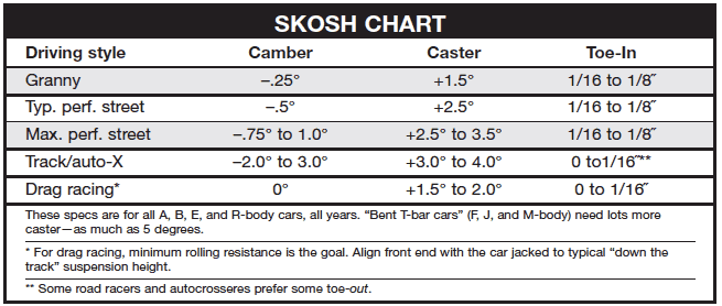

I went with the offset bushings stiffened my lower control arms. Torsion bars are the 340 spec .870 bars. Added a 1? inch sway bar then followed the alignment specs for street performance (pic below)
