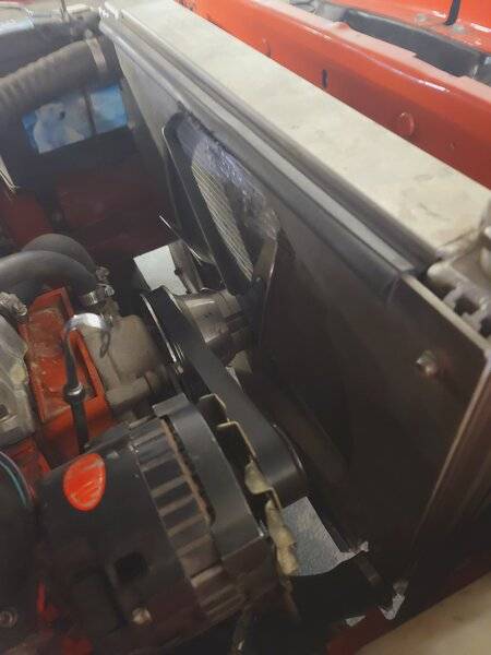

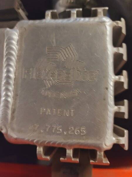

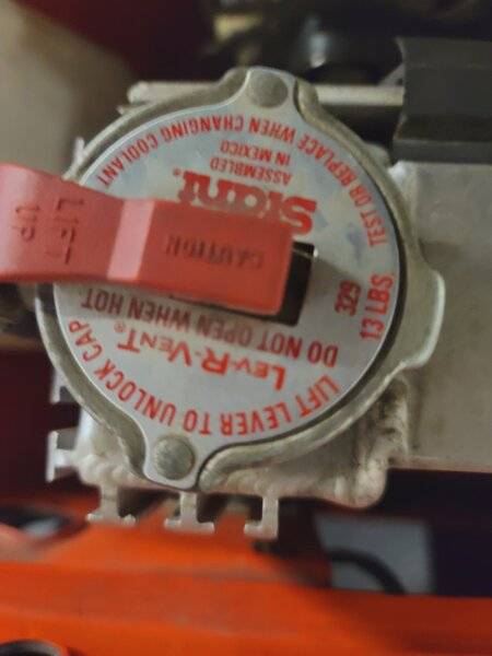

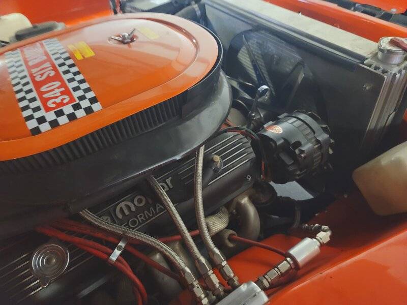

OK guys here are some pics to get an idea what I have/dealing with.
The rad is a Flex-a-lite
Stant cap, 13 lb
It's not letting me place the pics I will get again.
Thanks for everything thus far guys..

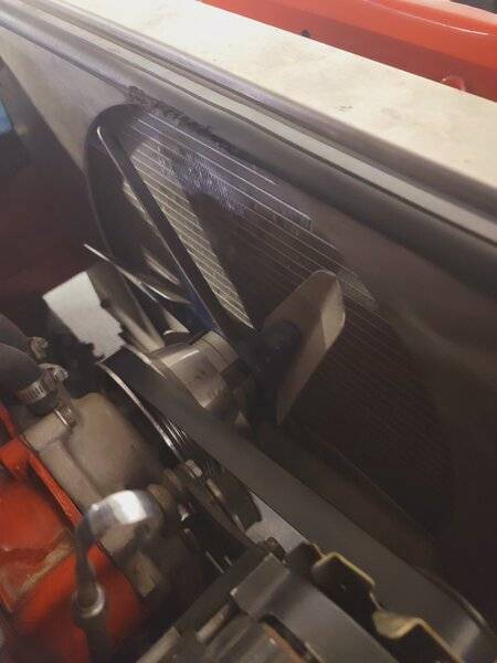

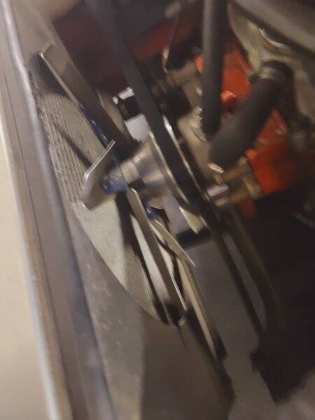

Had problems getting the pics up.
Just a few observations. That fan is a turd. There are a LOT better choices than that tiny blade flex fan. Next up is that shroud. It's blocking too much of the radiator core. Another way to describe it is, it's too close to the radiator. You need more air space between the radiator and shroud, OR you need to cut some holes in the parts that are blocking air flow to the rest of the core.
Finally, the 13 pound cap. That's designed for a stock radiator with a stock engine at a stock power level. Not one that's producing more power than stock. I would upgrade the cap to a 15lb, either cut some holes in the shroud to expose more radiator core to air flow, or move the shroud back away from the radiator for more space and finally put a GOOD fan on it like for instance a Chrysler 7 blade or the staggered 5 blade fan. Doing those things will very likely solve any over heating issues.

Nice clean radiator is certainly a must! Based on the pics though I am going after the fan and shroud first. My car with similar equipment would run as high as 220. Today it rarely gets to 190!
