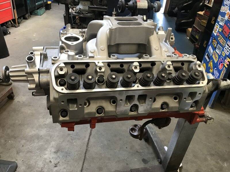

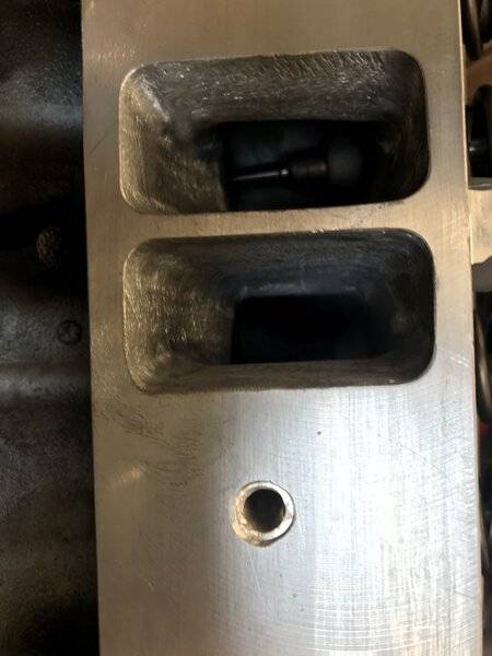

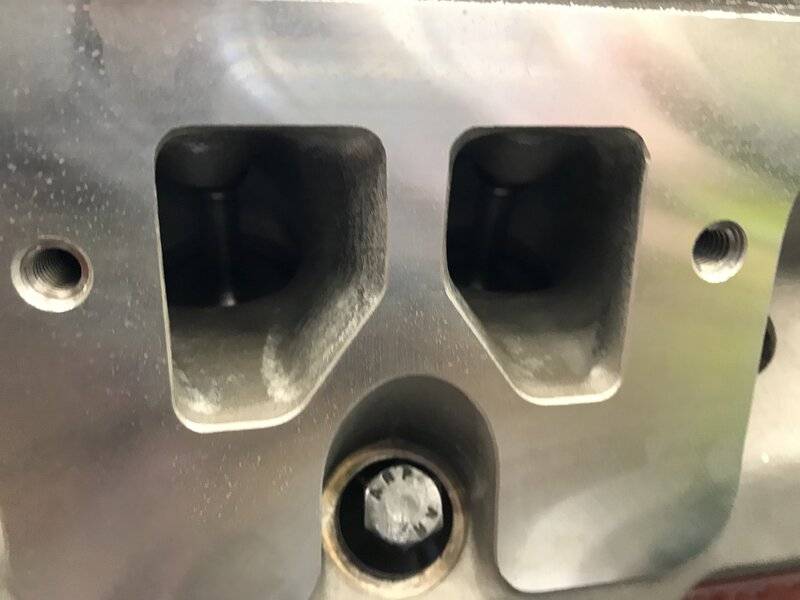

The good times didn't last as it started knocking pretty bad and parformance dropped off so bad that I could barely get up the hill on my driveway. With the report of a previous oil pump replacement I decided to just have a different 318 built with a '73 340 cast crank I had laying around. Around this time Speedmaster (alloy heads) was having one of their salse so I got a pair of bare heads and an air gap intake.

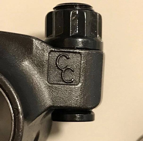

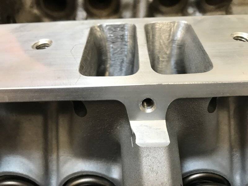

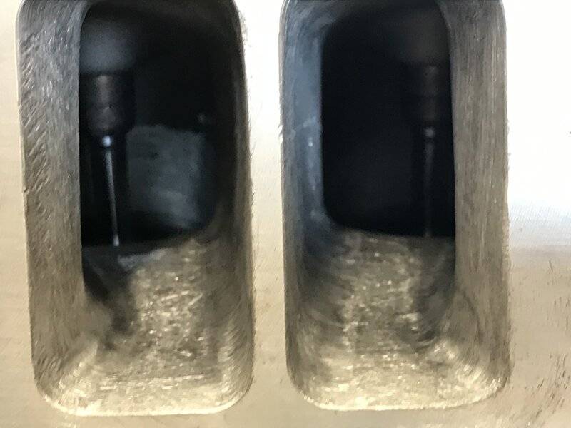

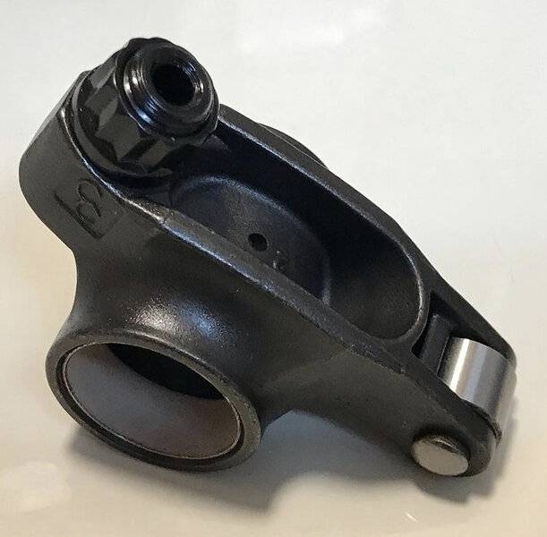

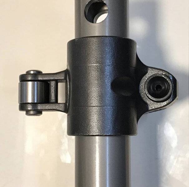

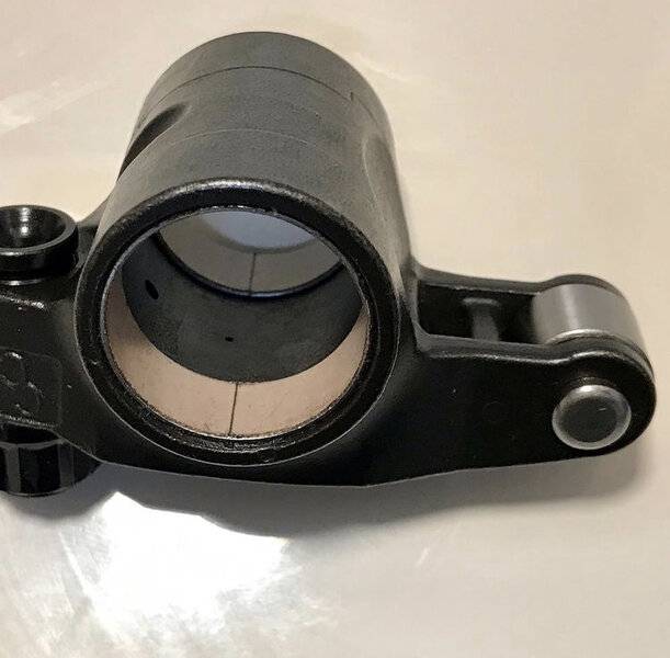

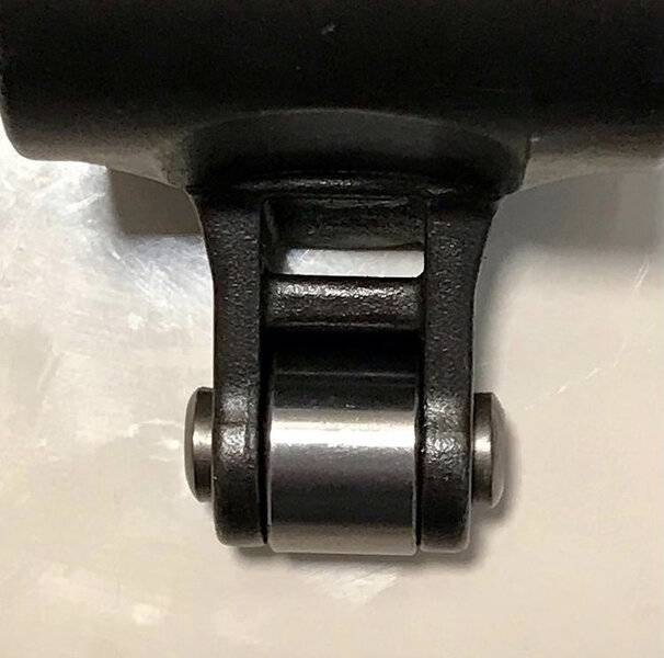

Specs on the new engine are .060" + for "328 cu in.", '73 cast 340 crank, Eagle SIR rods, KB167 pistons, GJ oiling mods, HFT 224/230 @.050 lift on a 110* LSA, Competition Camshafts adj. rockers, bowl blend on the SM heads and gasket matched intake. I am thinking about an FBO ready to run distributor. Fresh 727 with mild work, the shifts are a little firmer but nothing crazy that is annoying for street cruising. Stock converter, 3.23 gears. This is just a SWB, parts chasin'/run around town "sport truck".
