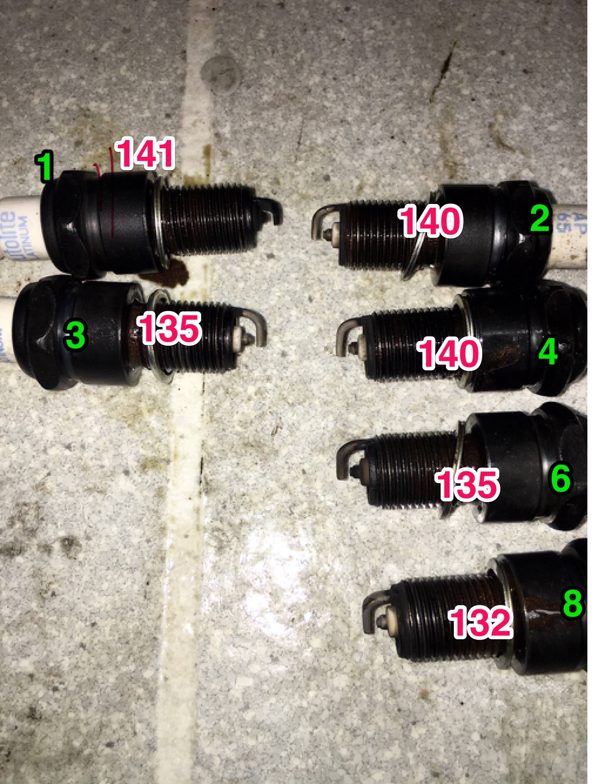

Ran compression while it was warm. Here are the results. Tighter than last time. Also, you will see that #1 and #6 are black. (5 and 7 have a header in the way).
You have to get 5 and 7 out for sure and see what's going on there? Get something in there to break them loose even if you have to make something and then use a piece rubber fuel line push it over top of the spark plug and spin it out.
Ohh I can get them out. Just don't want to...maybe I will tomorrow.
Why would #1 and 6 plugs be so black with the others normal?

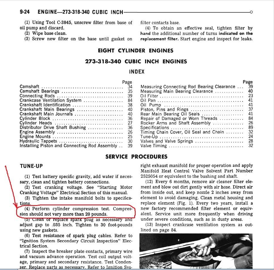

How about we throw opinions out and go with FACTS???
(Opinions are like @ssholes, everyone has one and they are all full of ****...)
The 69 Dodge service manual states that there should be no more than 20 PSI difference between cylinders on a compression test...
Also, I would do a dry test, then a wet test where you put a few squirts of oil in the cylinder and then check compression. Compare the numbers wet to dry for each cylinder and see if there is any significant difference...

Finally got time to test compression on 5 and 7. (Stupid header). About 132 each. Both spark plugs where cracked, 7 had a white tip and 5 was black. Changed the plugs and it is running the same.
Best was to describe the sound is a rhythmic slapping sound. Blap blap blap. Just doesn't seem right. Still doesn't like to idle at 600-700.
Motor shakes a lot. Causes random "cavitation" sounds in the cab.
Doesn't have the power I expect.
Is the discoloration on the plugs telling me anything? 4 are perfect color, 3 are black sooty and one had a white (hot) tip.

I don't think plugs one and six have anything in common along that line though, but there is definitely something up with that plug pattern for sure.
Almost looks way out of time, or weak spark along with running way rich with an intake leak. :D
