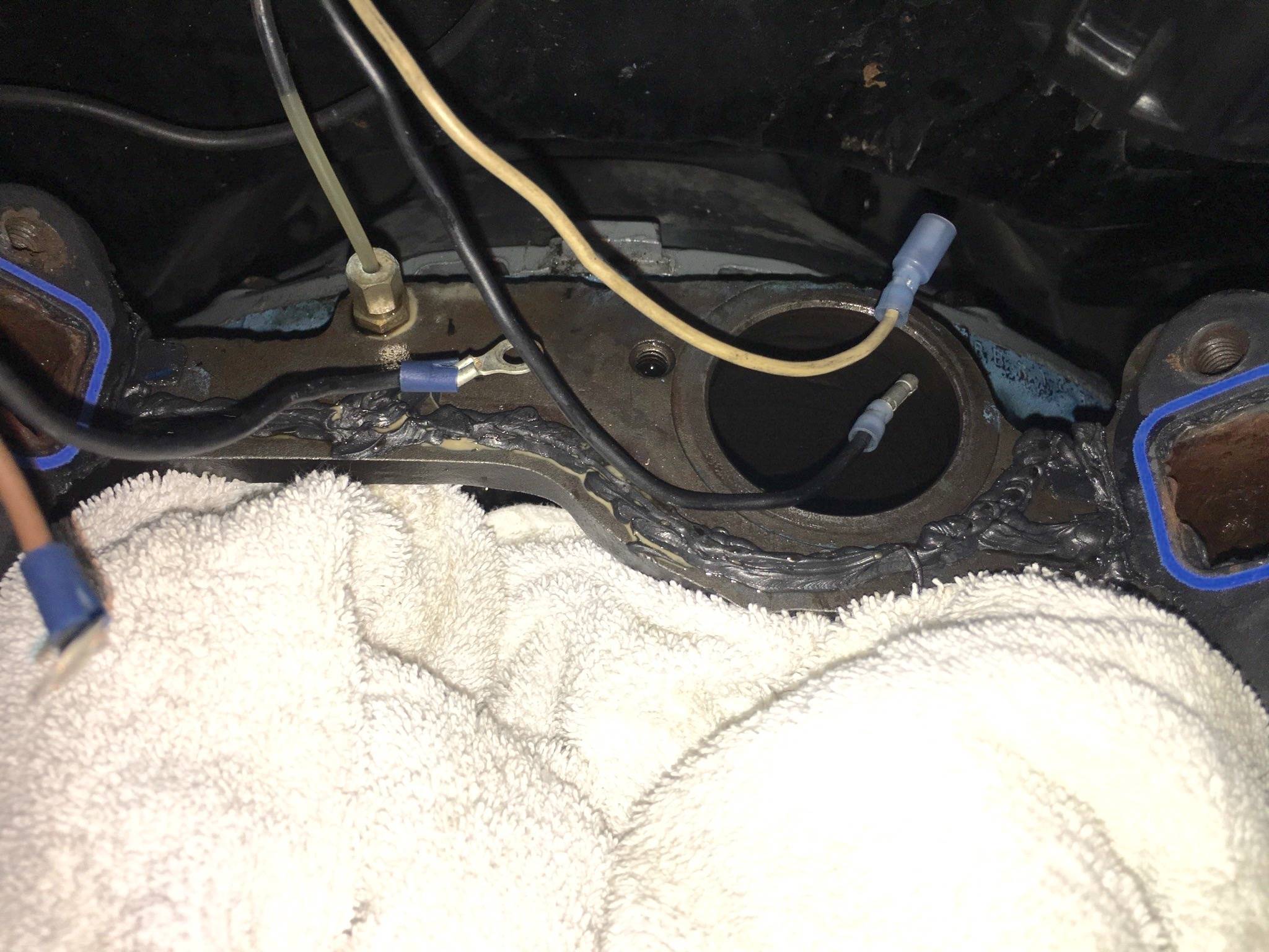

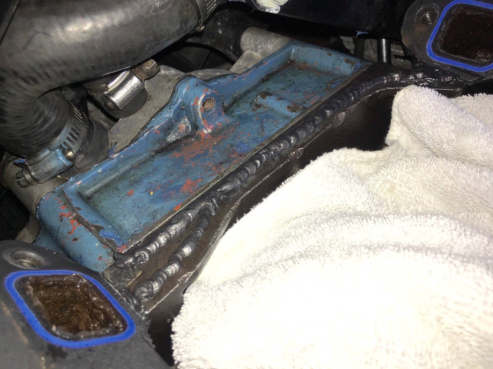

Yep, right stuff! I just didn't use enough last time. Pic below.
I have those tabs in the bottom. Should I bend them up, put right stuff below and in the corner, then bend them down into the right stuff?
The gasket looks fine and is in position so I guess I will keep it there and reuse it. But it blocks the pass through port without a backing plate which, as I have been told, will break down over time without the plate. Maybe I should get the backing plate?
If your not using the cork gaskets on the ends, you need more RTV, especially on the ends by the water jackets. I would run the bead almost up to the blue lines. the metal tabs can be just laid flat on the block.

mopar says, to put a sealant bead around the end water passages on heads and intake manifold. I've always done that, they can leak water into engine. also, I use a silicone sealant to seal with. follow the mopar sequence for tightening the bolts. bend tabs down!!
Remember to stack the beads on top of each other in the front and back to make it thick because there is a quarter inch space there that you have to overcome. not two wide but two high stack them on top of each other. And plus everything everybody else is saying

Some combinations of heads and intakes work fine with the original end gaskets in place. I would temporarily place the intake on the heads and the intake gaskets and snug down just the corner bolts a tiny bit to see how big the gap is. If it is large and close to the size of the cork gasket thickness, then I would use the cork gaskets and a skim coat of black RTV as a sealer and glue, with blobs in the corners. We have a 340 that uses the cork gaskets just fine. So it depends on the particular combo.
I cut the end tabs off with a razor just to keep them from getting in the way and causing leaks. They are just an assembly aid that likes to get in the way!

Only cream was on the back deck. You can see it against the right stuff on the right side of the block.
that RTV doesn't look compressed
am I the only one who thinks the intake never touched that bead?
it's probably a good thing you didn't get it running right - that would have gotten ugly once the oil pressure came up. It looks like the seal never mated with the intake. REALLY glad to see you decided to get after it yourself!!
