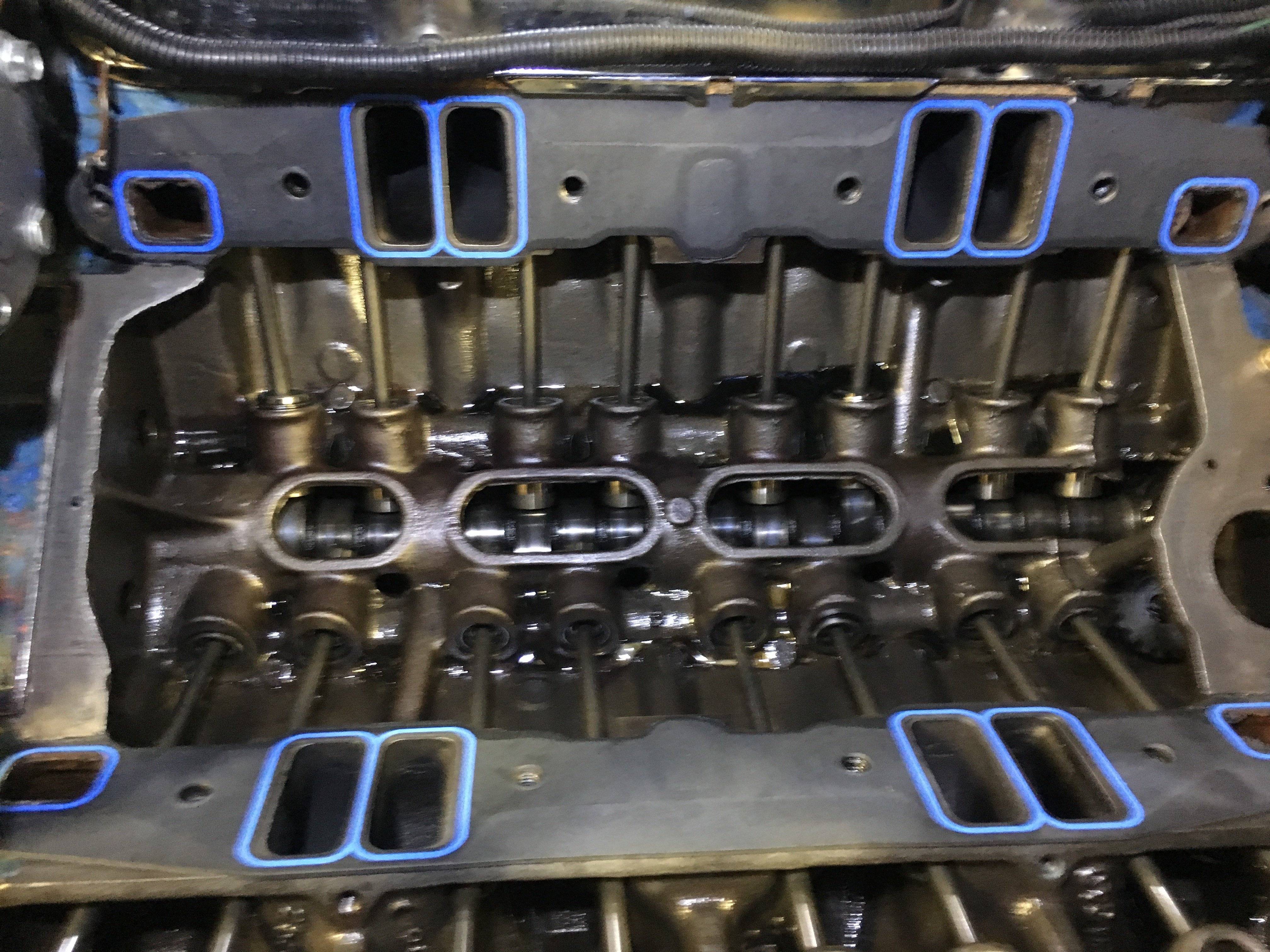

Ok. All ready to put the top back on.
Who votes to use right stuff around the gasket cutouts?
I will be using right stuff on the front and back. Double stacked this time! Gaskets are fine and didn't need to come off.
I'm just going to let the heat burn up the gasket over the middle hole.

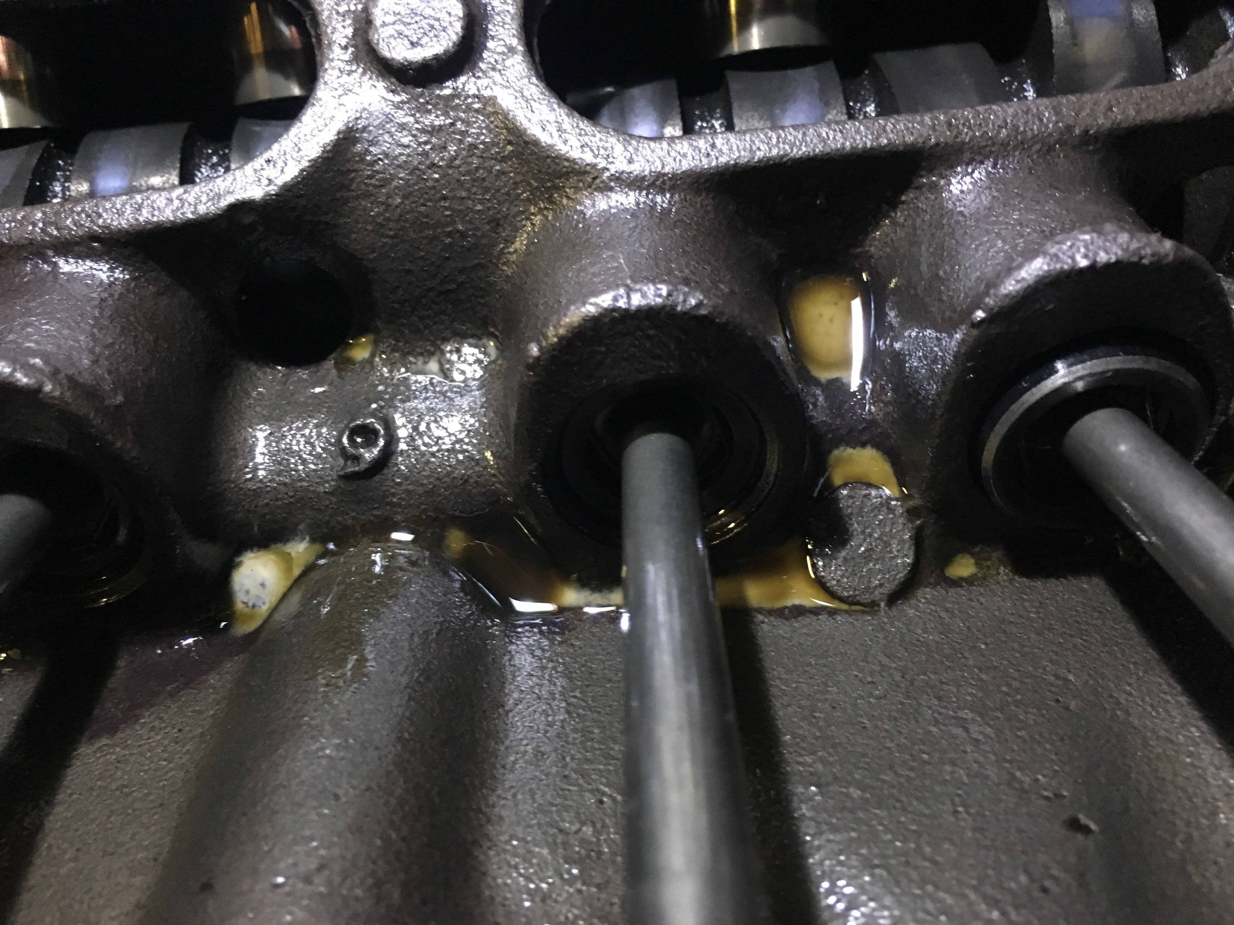

Here is that weird cream goop. It is in one spot inside the engine. Will wipe it out but seems weird that it is basically in the middle of the motor. Looks like mold.
use it around the water jackets.... all 4 of them, both sides of the gasket. just takes a thin amount.
I also put a thin layer of indian head around the intake ports on both sides of the gasket.
This has worked for me on many, many intake swaps. However, each one has to choose their own way.

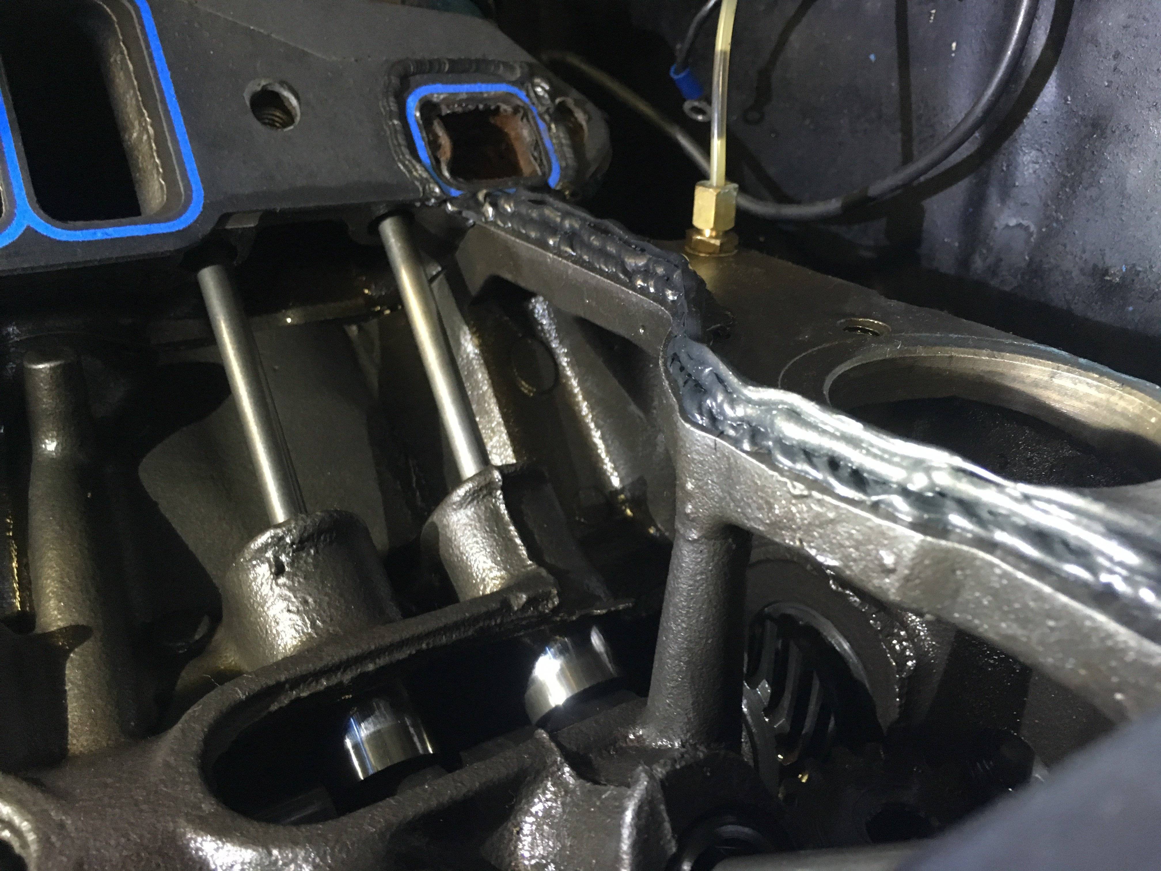

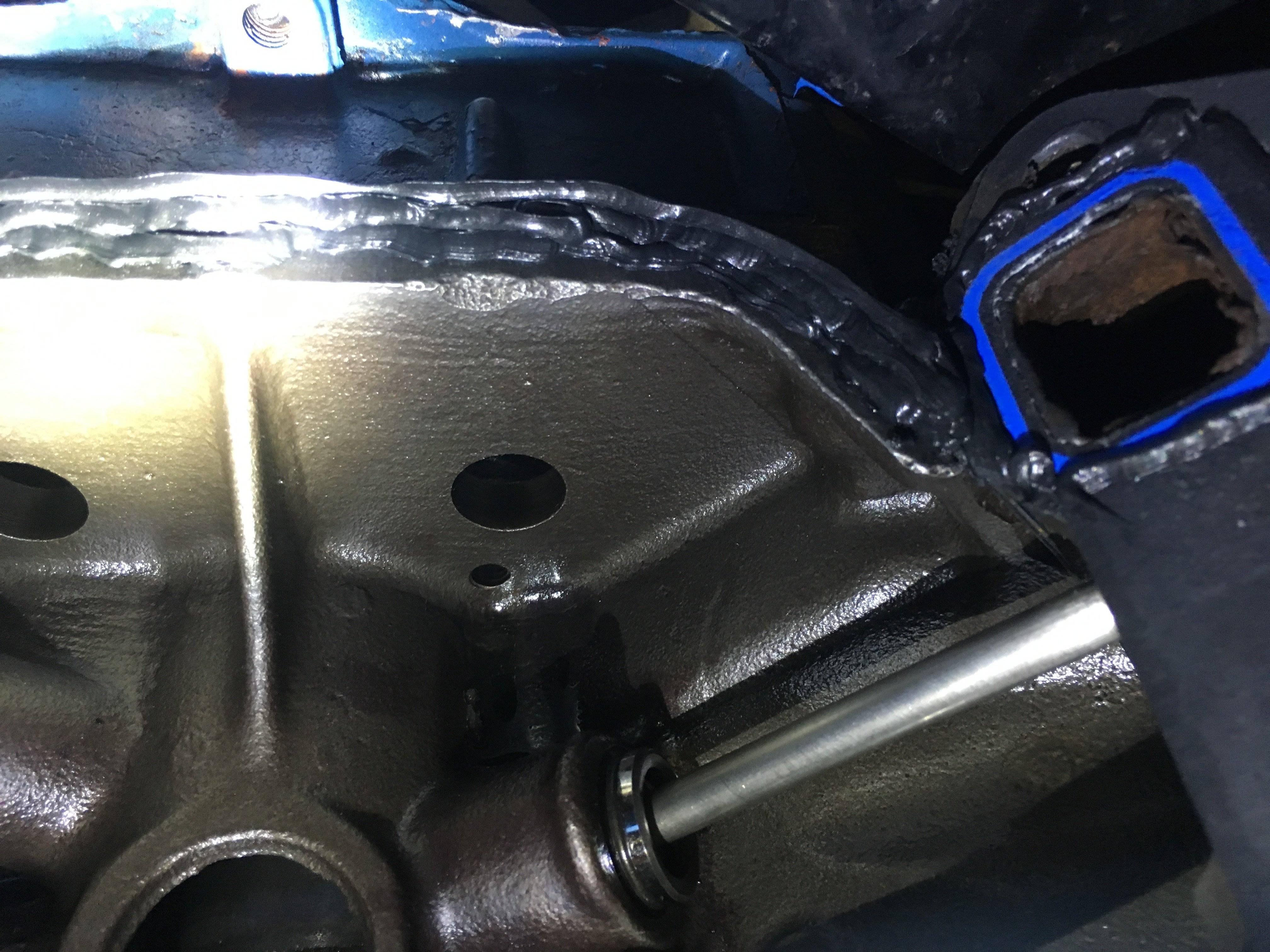

Ok. Stacked three lines. Thickest at bottom. Also around the water openings.
This should be good ( knock on wood)
Looks like you have plenty of RTV there, I am still wondering if the leak was not from the plastic oil pressure line??????????
Yes the right stuff, anybody on this forum knows I'm a big advocate of this ATV. But in the same respect you are putting three layers on top of each other and it takes a little while for this to get to it full strength and potential. If you were just putting a thin layer on your thermostat housing sure clamp it down and take off.
It's Right Stuff. Directions say you can use immediately. But I won't be driving it for a day anyway.

How did the old bead look, solid inside or mushie like a undercooked brownie ?
Oh, and some of those intake bolts go into the oil gallery if there is no sealant on there maybe that could cause that milky substance your seeing?

Oh, and some of those intake bolts go into waterjackets, if there is no sealant on there that could cause that milky substance your seeing
So I need to seal them? With what and which ones?
