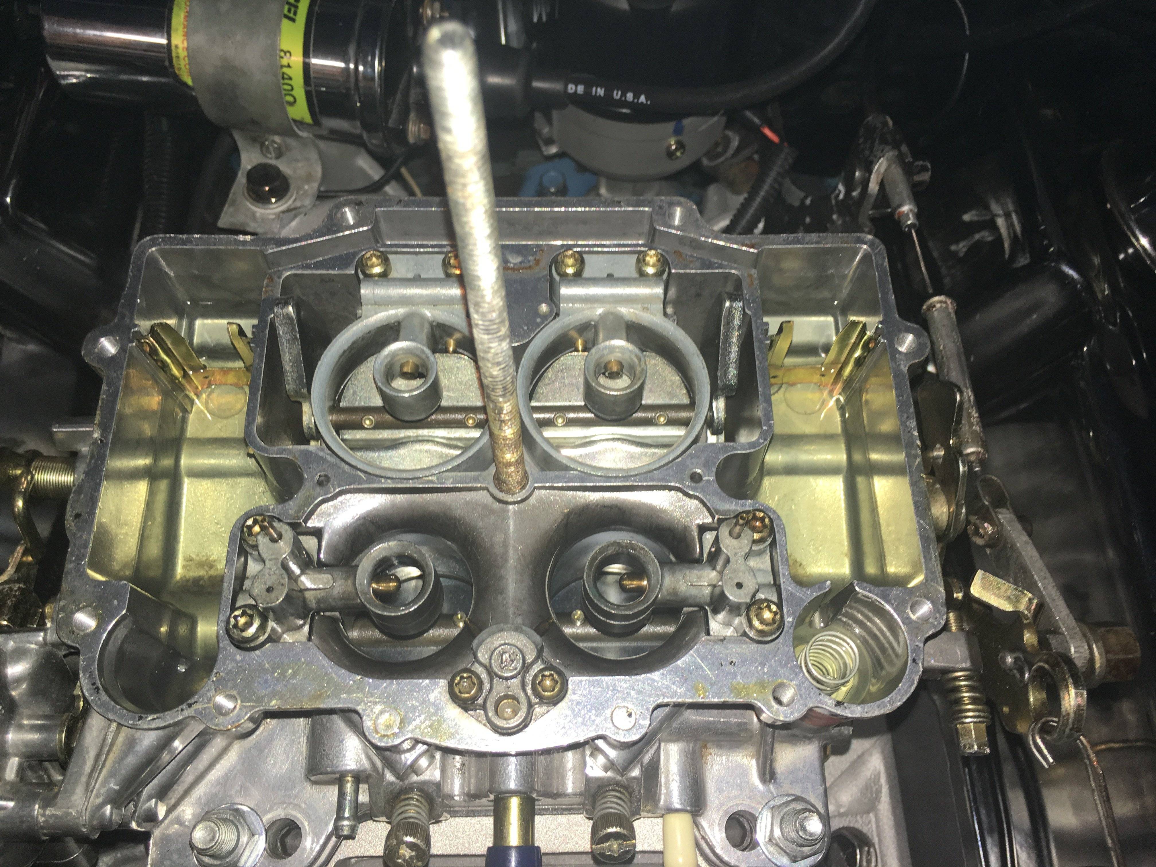

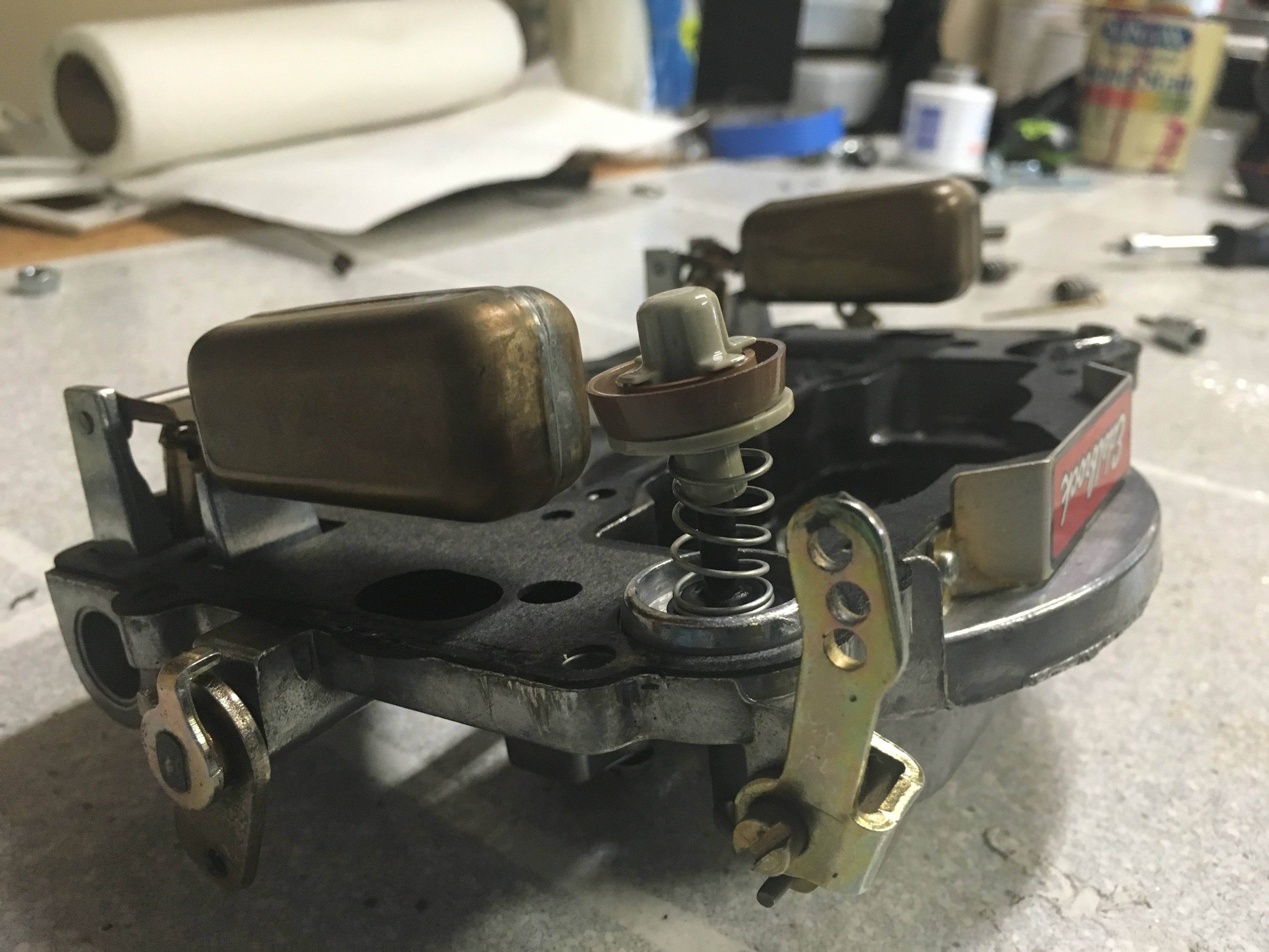

Opened the carb up. Floats and other components look fine. There is a slight black residue on the front ports. Not sure if that is normal or not. See the pics.
Moving on to double checking the spark. Will also visually inspect for TDC and make sure timing and rotor points are aligned.
well, there is your problem...your carburetor is not assembled
of course it wont run that way

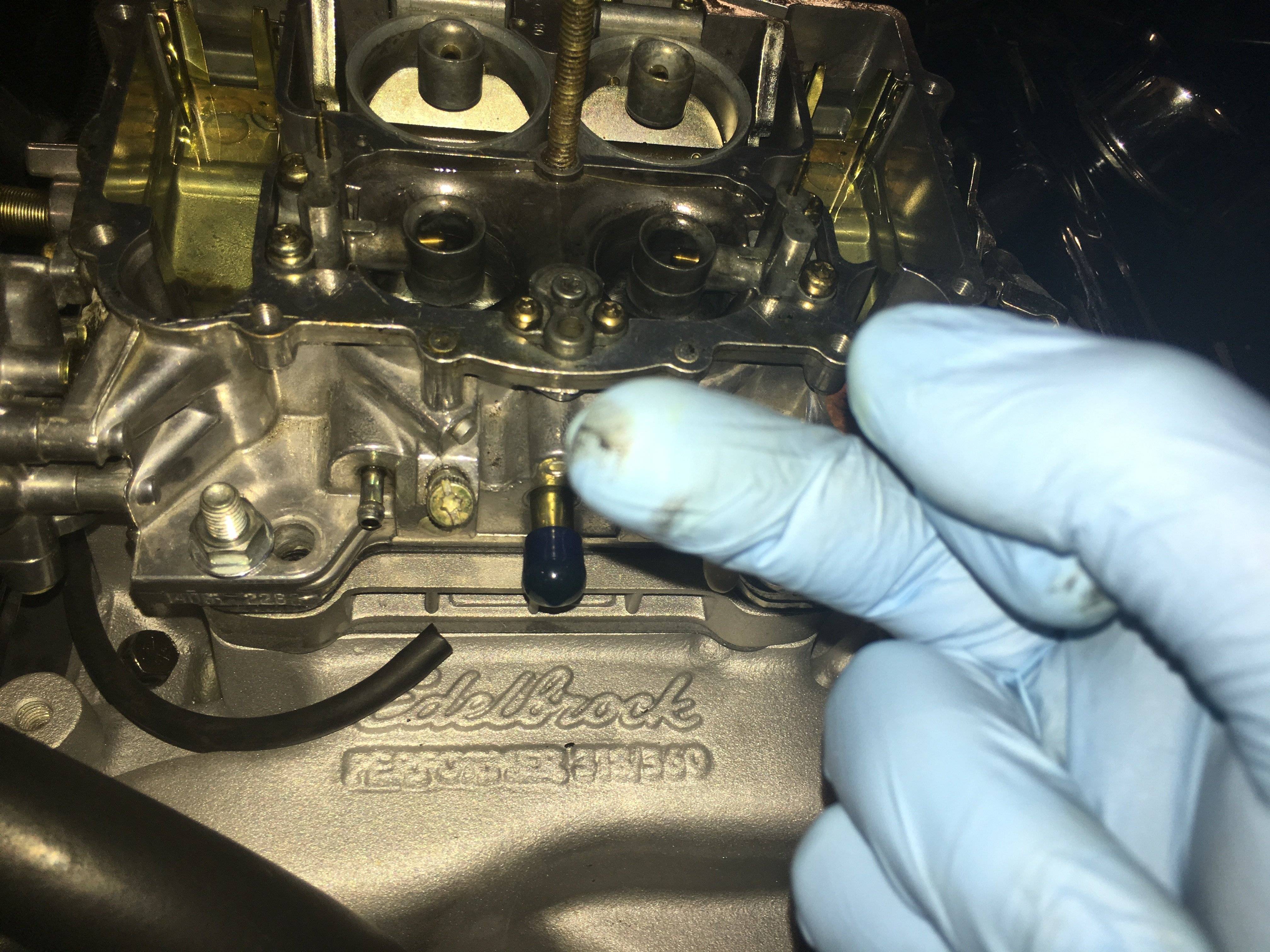

not running a PVC valve?
or did you accidentally hook that up to the power brake port on the back ?

Didn't come with a PCV valve. I have had the car for a month now. I'm assuming it gets plugged into the large port on the front? The valve covers have breathers but that's it for ventilation.
PCV goes in the front port, booster in the back you might have a plug in there for non pb cars.

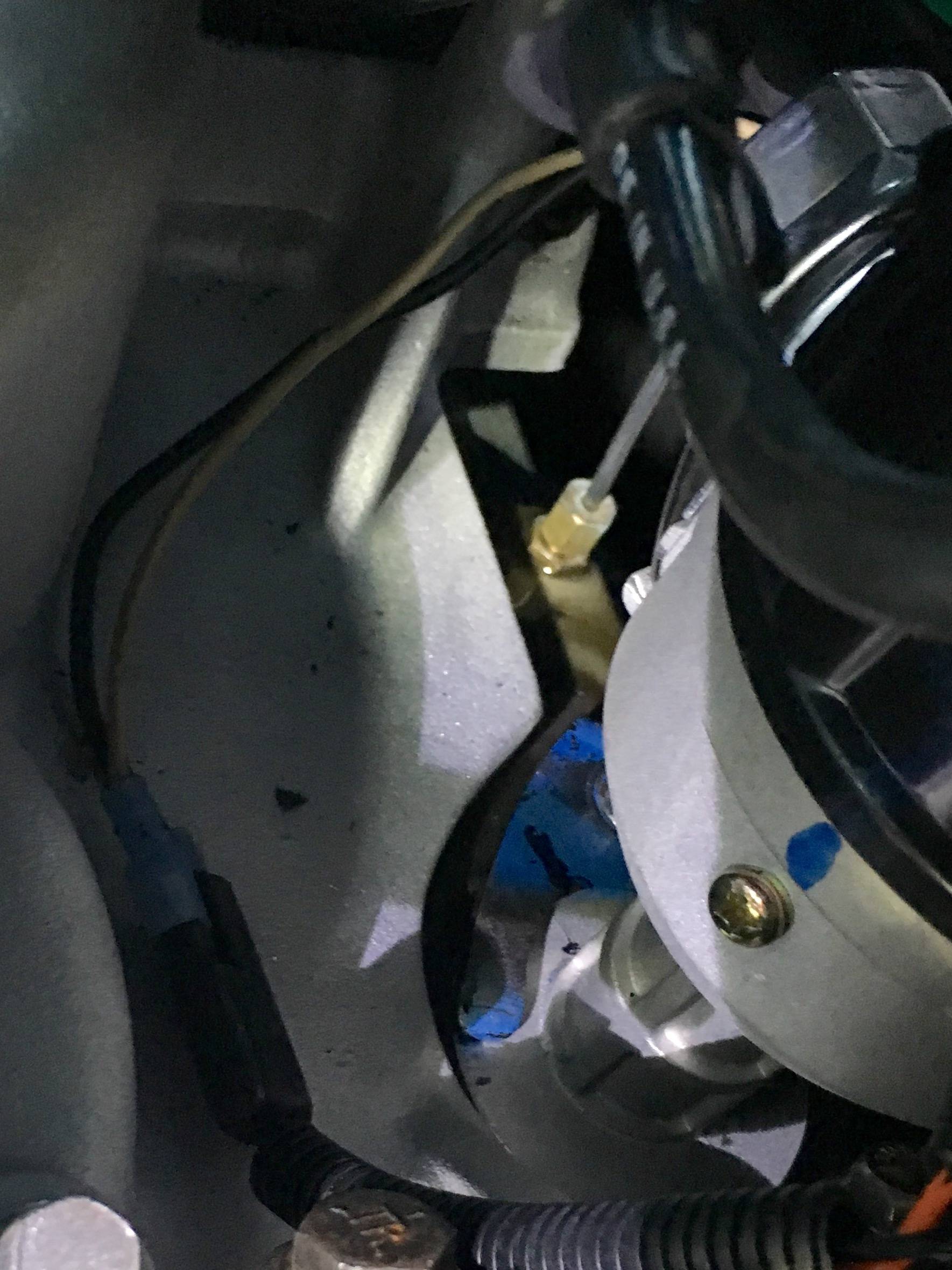

Although, it doesn't matter. Turns out I didn't put enough Right Stuff on the back seal. Crap just pouring out of the back and dripping on the headers....even worse than before. You can see it at the brass plug.
I can't do this again, going to take it to the shop and have them fix it.
that bites there sparky - it's gonna run ya several hundy to have someone else do it - I know it's not what you WANT to do - but you can
