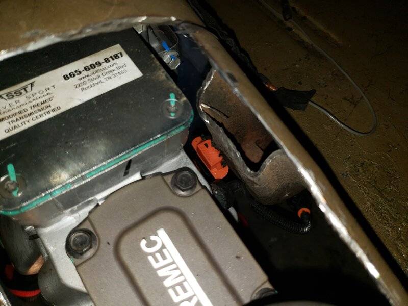

There is ONE thing keeping me from purchasing a TKX PerfectFit kit from Silver Sport Transmissions. The cut you have to make to the upper part of the torsion bar crossmember. They supply a crossmember for the TKX, but that only replaces the lower part. Unfortunately, I don't have numerical data to analyze how much that upper section is actually used by the torsion bars, but from my eye calculator, it looks to be important. Here is a picture of how it would look like: (pic from @jcolman )
Short of fabricating a replacement piece (which I'm not very comfortable doing with my current skills...), I was hoping to get suggestions of alternatives. I was wondering if frame connectors and torque boxes from US Car Tool would be adequate? Again, using the "eye calculator", it looks like they would give the twisting forces from the torsion bars more places to go. I contacted ToddRon Restorations but unfortunately no offerings for the TKX there.

Figured it's my duty to update this, since there is now a TKX in my A-Body lol!
Silver Sport Transmissions have been fantastic to deal with, top notch customer service. No regrets, highly recommend!
As far as cost, the complete kit was right around $6k, with everything I could ask for and more. This is including a nice dial indicator to measure bellhousing run-out, a better clutch than what they include in the kit (I requested a 700hp unit), and their hydraulic concentric slave cylinder which is a $650 upgrade.
As far as ease of installation, my mind is still blown. I was able to do 90% of the work in 2 days. From 727 out, to TKX in. Now only waiting on FedEx to deliver the 31 spline 1350 slip yoke from Strange, and 1350 pinion yoke so I can measure for a new driveshaft and get that going.
As far as the cutting, it is WAY LESS than a T-56, or TKO! Like Silver Sport mentions in the instructions, those instructions were developed for the TKO, so the TKX may require less cutting. What I did was, I completely ignored the instructions and cut little by little, to figure out the least necessary amount. Check it out:
As you can see, apart from the obvious opening for the shifter, the tunnel only needed that minor split in the middle. That gap is so small I could even just fill it with weld lol!
Now, the part that hurts. Yes, the upper section of the crossmember does need to be cut. I did everything in my power to avoid it, but I couldn't. So I still need to figure out a way to re-join both sides. There is no way in hell I'm just leaving both sides disconnected like that. Here is another picture for a slightly different perspective:
