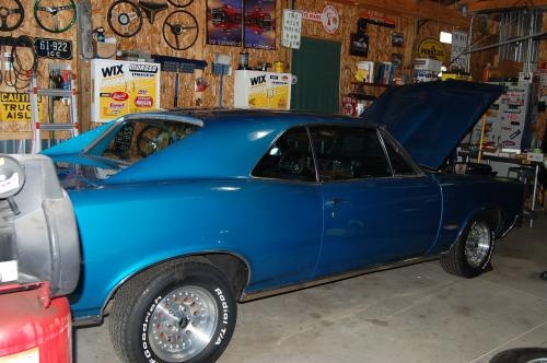

The Dart is mine race car which this engine was in, The Monte is also mine, I just finished redoing that and The GTO i am working on it for a guy.
