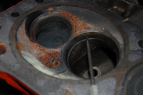

I have to agree with some of the others. I too have seen bent rods and split cylinders from hydraulic pressures.That dark line stops short of the deck, about the thickness of the deck. It's very suspect.
It was running a week ago and went 11.20 @ 120 mph
Intake is W2 mopar M1
Thanks Guys .. I was pretty pissed off last night when I saw this.
They where a brand new in box set of W2's
no way did the head come from mopar with epoxy
