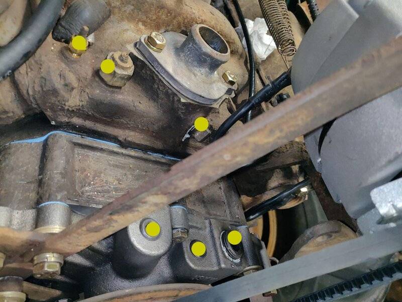

Which of these 6 holes would've most accurate reading water temp returning from radiator?
I got a hunch its anything on the water pump housing, but I'm no engineer. And water flows backwards on mars,,
None of them.
The water comes out of the bottom of the radiator and goes into the pump then into the block.
All the water on top of the engine is coming from the engine and going into the radiator or bypassing the rad.
Why do you need to know the rad return temp?
I don't need to know it, the electric fan does.
i was going to use a hole in the intake manifold for the "dash" gauge for me, after it's gone past the sleeves, head, intake, and out at the thermostat. That seemed most accurate to me.
But I need to do some custom plumbing on the hoses, so maybe i'll bung a hole in there somewhere. I assumed the 3 plugs on the water pump housing are on the other side of the impeller, which is on the timing cover, so it's not part of the block. But maybe Mar's doesn't have water. I could be wrong.
I have never seen an electric fan that measures the output temp from the rad. That a new one for me. Typically they measure the engine temp from the coolant going into the Rad to determine when to turn on, an one the temp is below the set point they turn off. As in 180 deg thermostat 190 turn on 185 turn off that way the thermostat is open to help regulate the flow through the RAD. I know your running without a thermostat so the fan will maintain the high engine temp and load and OAT will dictate the low engine temp the return temp should be around 50 deg lower than the supply temp from the engine so, IMHO it will be more complicated to measure the return temp to regulate the engine temp. BUT it can be done. we are talking the same here, the upper rad hose is the output from the engine and the lower is the supply to the engine correct that's how you are talking yes?
correct.
after water flows through top hose, top tank, cores, bottom tank, then the return hose going to pump, and if water is still too hot or climbing, probably because of my 1/4 mile runs @ 7 minutes @ 3Mph, it'll trip the fan.
Seemed simple enough to me. Not having the bypass hose or a cabinet heater core circuit makes the water flow much more direct.
