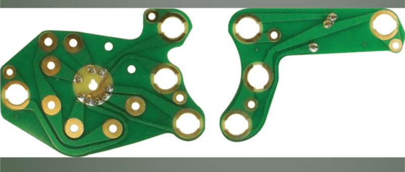

You can trace out what each wire does and where it should go on the cir board.
Yellow fuel gauge
Red Ammeter
Magenta oil pressure
Blue water temp
( I might have temp and oil swapped)
The upper left most hole on the fuel gauge provides about 5-6 volts to the fuel, temp and oil gauges.
Yellow fuel gauge
Red Ammeter
Blue water temp
