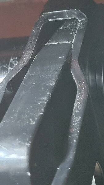

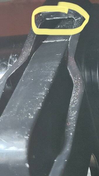

Does this look like a crack to you?
I dont know, didnt notice it before.
do these things crack?
To me from the picture it looks more like it’s contacted the lca.
Yup. Looks like the LCA hit the adjusting lever which put a mark in the powdercoating.
Those surfaces shouldn’t come into contact, so something about the ride height or suspension adjustment/travel range is off.
Ok, yeah after pointing that out, I see it now. Whew...
I installed the adjusting bolt 40 1/4 turns on both sides just to have some preload for when it comes time to put it on the ground. It must have happened when I used the jack under LBJ to guide the knuckle into the UBJ. I must have gone a little overboard on that side cuz I lifted the car.
Thanks guys.
