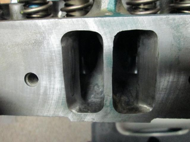

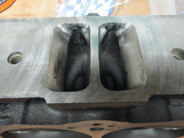

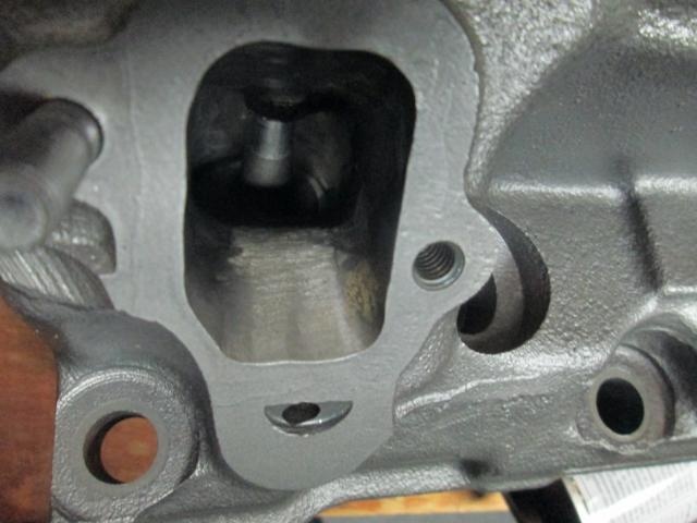

So the shop has the heads just about done. Port matched and bowl blended, 3 angle valve job, milled .030 to raise compression to 9.1. Dropped off the locks and retainers and went with Lunati roller cam 219 227@50 with .515 lift. Should work well with my 625 Demon and airgap intake. Cant wait to fire it up!
The good news. The heads are finished. The bad news is even after milling .030 they're still 72cc yielding an astounding 7.98 comp ratio. For a block that's supposed to start out at 9.1 its a huge disappointment but the piston sits .097 in the hole with a .067 dish. I was planning on avoiding the whole bore/piston/balance/geometry stuff. Looks like I'll end up with a 30 over. I guess its not a problem time and money can't solve.

I havent learned enuf yet about milling for increasing compression etc. Maybe run with these until you save enuf sheckles for another set of heads down the road?? Sorry to hear, but at least the shop didnt butcher them.
Its really my fault, I believed the advertised compression would be off only a little bit. I should have measured everything. I just never thought I could mill them and still go from 9.1 advertised to 7.9! Getting a quote on pistons and machining, probably lose 3 weeks. Looks like a late spring anyway.
I can't wait to see more-I along with many others am sorry for your loss, but very glad you got to reacquire the car. Kinda sucks that after all that work you find out the slugs are that far in the hole-really?? 0.097"?? damn!
You don't mill Mopar heads to gain compression. You change pistons. To go from 7s to 9s in compression will require over .100" to be milled off the block face of the heads and a ton from the intake side. I don't understand why people insist on doing things the hard way. In another thread there's a guy askin if he can use old stock valve springs. Really? Everybody has the same internet. These are basic questions. Mopars came stock for the most part with dismal compression ratios. There are many nice affordable off the shelf pistons that will raise the compression pretty much to anything you want. Now as it is, you have a pair of heads that you will have to custom mill an intake for and use only on that particular motor. Stuff like this can easily be avoided by a little research. These aren't Chevys. They build a lot differently.

Naw yall ain't stupid. Everybody's gotta learn somehow. The big problem is Mopar's exaggerated deck height. The book says one thing but the actual block measurement will always be high. Real high in some cases. Couple the high deck height with pistons that sit in the hole .100" or more and compression is in the 7s real quick. That kinda thing caint be solved by millin heads. lol
Lesson learned. If I can get away with pistons and a trim on the intake I'll be happy. My oldest son is going to be home on leave at the end of May. Hoping to take him for a drive. He will get this one eventually.
