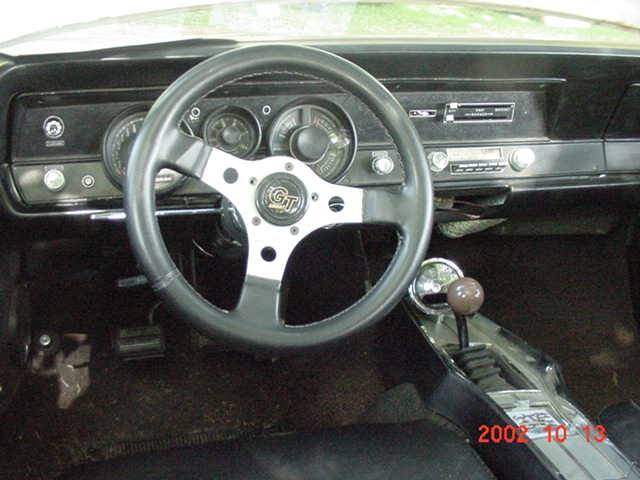

Something like this with backlighted text at LIGHTS HAZARD WIPER can be had if you got lots of money. Backlighting the climate controllers isn't completed yet ( lack of funds ).
