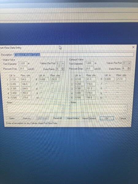

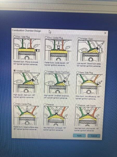

It doesn’t ask head cc size, and as far as what head style it’s pretty limited. You can enter flow numbers.
I just bought it (Competition products is just down the road from me) so still learning. There may be a way to get that stuff in there
