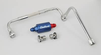

Okay, so I'm reading the instructions that came with carb and they mention an optional Dual Feed Fuel Line Kit for an additional $86.
My question is, is this kit necessary and will I notice an increase in performance by running it or decrease by not running it?
It doesn't increase performance. It helps insure fuel delivery.
Not needed.
I didn't mean actual HP or torque increase, I meant is there a chance of sucking one side dry in a 1/4 mile run.
Well maybe needed or not, I bought it for mine, (dual feed lines have a slight cool factor to me) did it make a difference?? don't know cause I put it on from the get go, from all the posts that I have read from rumble I would have a tendency to believe him, but it's your $$$.
