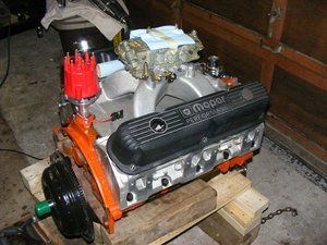

I am wondering what everyone here is using to keep spare motors on besides engine stands. I am looking for something I can make or buy reasonable. Need something I can roll around. I have seen lots of cheep ones for small block chevy but seems like anything for a mopar small block is double the price.
When I got my engine home,I had some 2x4,s and some 6x6,s to set the engine down on.I guess I could,ve made a bottom with some wheels to move around,but nope I put it right back in the car.
