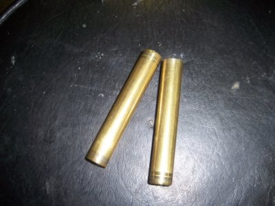

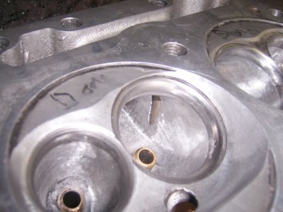

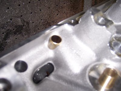

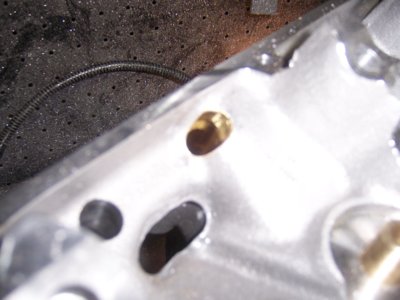

I've gotten into the habit of sleeving EVERY small block Edelbrock head I port. I tube both the bolt holes and pushrod holes so I can kiss the tubing. The straight wall on these heads needs pushed over badly. I use JB Weld on the tubes when I install them and Splash-Zone epoxy inside the port after the job is done.

If you look at the one picture you can see how much I have ground into the solid tube. When I’m satisfied I will then drill the pushrod hole where I want it
