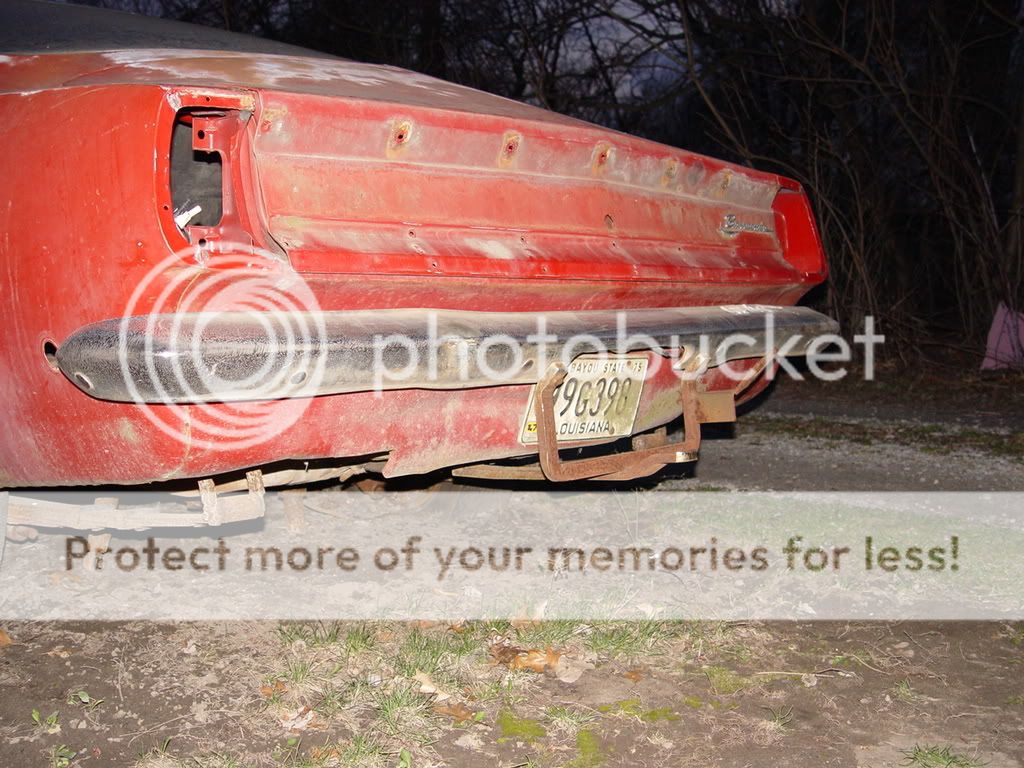

This car has a somewhat strange history. The story as it was told to me:
The original owner was aparently a semi-pro drag racer back in the sixties in the south. He bought this 1968 Formula S fastback new for his wife. for a whopping sum of $3661.56!
After a while, he got the itch and decided to race it. The inner fender wells are cut out for fender headers *GRR*. I think the car also ended up with a big block. Anyway... Eventually the guy started exploring other hobbies like learning to fly. One day, when he was doing some side work flying fresh fish from somewhere in Mexico to a little restaurant in Texas. One day, some nice gentlemen from the DEA decided to pay him a visit when he landed, and then he went away for a long long time.
Apparently, before he went up the river, he gave the car to his good friend to keep safe for him until he got back. The motor and trans were yanked and sold, and the car sat outside in Mississippi collecting rust and moss until the son of the good friend eventually traded it to me along with a basket case Industrial HEMI motor for my '78 Formula Firebird.
So anyway, The car is pretty far gone. The interior is almost entirely trashed, the body has surface rust all over, bondo in the right quarter, some penetration rust just in the corner of the front fenders, holes in the front inner fender wells for headers, and to top it off, some jerk stole my hood!

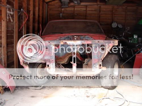

With all that in mind, I'm going to build a G-Machine style car out of this thing. As you can see in the pics, I've already started taking off some of the trim (which is in really good shape, thankfully) and stripping out the interior. It's going to get an AlterKtion, a Chassis Engineering "Top Gun" four-link rear, and a modern power plant to the tune of about 450 horse.
I'll attach a few more pics here, but the rest are in my gallery. I can't post pics straight out of my gallery because my webserver is just not fast enough to keep up. So here are some from photobucket, and you can see the rest including interior and exterior at http://gallery.halfront.com/1968-Barracuda-Formula-S-fastback
This car has sat for a few years since I got it, but this year I'm finally going to be able to get to it.

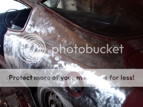

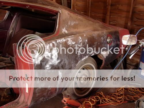

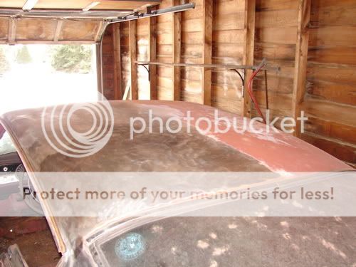

Getting the doghouse off. Got the rusty half of the roof and the left quarter down to bare metal. Good progress. Pics tomorrow.
Here are the latest pics as I'm stripping the car down to get rid of the rust. As you can see, I got all that rust off the roof. I got the left quarter down to bare metal and found a very small bit of rust and a very small bit of bondo. Not really as bad as I thought it was going to be. I still have to get that rear bumper off, get my windshield and rear window out, and remove the trim under the quarter window before I can finish this side completely. Hopefully I'll have that done tonight, right door and fender tomorrow, and finish stripping the outer shell this weekend.

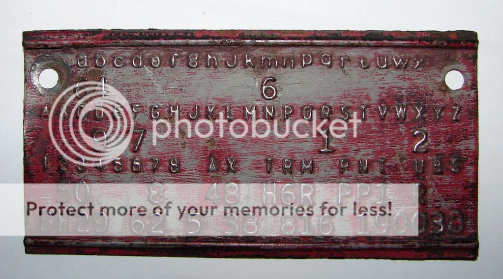

Here's the fender tag for your amusement. 8) The build sheet was not under the seat.
The only things missing (other than the motor and trans) based on the tag are the body belt mouldings (whatever the heck those are) and wheel arch mouldings. Those must have been lost when the bondo and re-paint was done in the first 5 years of the car's life.
Fender tag checks out as follows:
CAR: Plymouth Barracuda 2 Door Sports Hardtop
ENGINE: 383cid 4-bbl HP V8
TRANSMISSION: 3-Speed Automatic
TIRES: E70x14 Red Side Wall, steel belted
BUILD DATE: August 16.
AXLE: 3.23 Rear Axle Ratio, Sure Grip
INTERIOR: High Trim Grade, Vinyl Bucket Seats. Red Interior.
PAINT: Monotone Red Paint.
OTHER: Burgundy Metallic Upper Door Frame Color.
MOLDINGS:
25: Drip Rail Mouldings
30: Body Belt Mouldings
78: Wheel Lip Mouldings
ABC OPTIONS:
D9: Front Disk Brakes
F7: Barracuda Formula S Package
R1: AM Radio
X2: Tinted Windshield Only
abc OPTIONS:
a6: Console
b4: Bucket Seats
m6: Driver's Outside Remote Operated Mirror

Nice fish, but for the love of bacon please take off that damn trailer hitch and smash it with a sledge hammer then melt it with a torch so it can never be put on another car!!! I hate it when people put trailer hitches on cars! Any info on the industrial hemi?
What? You don't like the custom 1-of-1 hitch?
Heh.
I've bashed my !$!&@! knee on that stupid !$@&@*! thing so many !@*&! times....

As of right now, the entire interior of the car except the sun visors, headliner, and driver's side floor vent box is stripped out. The exterior is completely stripped apart from master cylinder and gas tank. Once these last few pieces are off and all the parts are removed from the garage, the remaining paint and rust will be stripped off and I can push the car out to clean the garage and put up plastic for painting.
When I push it out, I'll get some progress pics.
