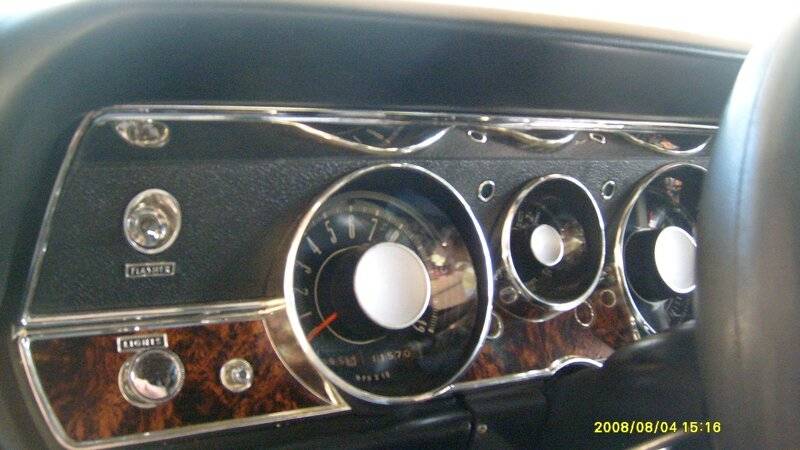

I like Redfish's IVR instructions above. Can anyone post pics to go along with this? Showing which wires go where on the IVR and then back to the circuit board, etc. Would be a good permanent 'Sticky'.
Any IVR you get should be marked 12 volt in, 5 volt out, and ground.
On back of inst' panel, the round harness connector has a locating key in its center. Fuel gauge wire is always dark blue and in this case, directly above the key at 12 o'clock. The switched 12 volt wire feeds nothing more than the OEM limiter. It is blue with white tracer and at about 9 o'clock position of round connector. It will go directly to your IVR no matter where you decide to place it.
One copper trace on the board ties all 3 thermal gauges to the 5 volts. You wont have a wire color or trace from round connector to here. 5 volt output from your IVR can go to any one of these 3 gauge posts. Circuit board does the rest. I use ring terminals, 10-32 hex nuts and a toothed washer on top of the original speedy nut for secure connections to gauge posts.
A solid state IVR doesn't require the noise capacitor so removing it provides a 90 degree push on terminal with short lead that you could use for 1 of the connections. I save those terminals for other uses since its a #10 and nearly impossible to find.

Perfect. Thanks RedFish. This would be a great electrical tech 'sticky' since it seems to come up frequently.
Yeah, a lot of members go to some degree of effort to create "how to" etc... That aint me. A lot of what I consider the best or simplest way to do something goes against what someone else has published online, long before me and they get all the traffic (that is how the internet plays.)
Maybe because they have "Engineering" in their title, it has already proved futile try to discount what they suggest (I did play their game for 8 years). You could look at RTE webpages and follow what they advise. Open you fuel gauge and bend some thingy if you want. That method to the madness works too. Ignoring me doesn't bother me.
My plan is happy moparing to all owners. I know how my own rally instrument panel works flawlessly. The three thermal gauges work, amp gauge is now a volts gauge and that works fine also. It should for many years to come.
During that 8 years, not only did I have a fuel gauge exchange program. It snowballed into owners sending me entire inst' panels to mod' to be just like mine, solid state regulator, volts gauge and all. I never heard the 1st complaint. I'm so proud of that. I'm retired today and doing nothing but typing. I'll be here to help you anyway I can.
