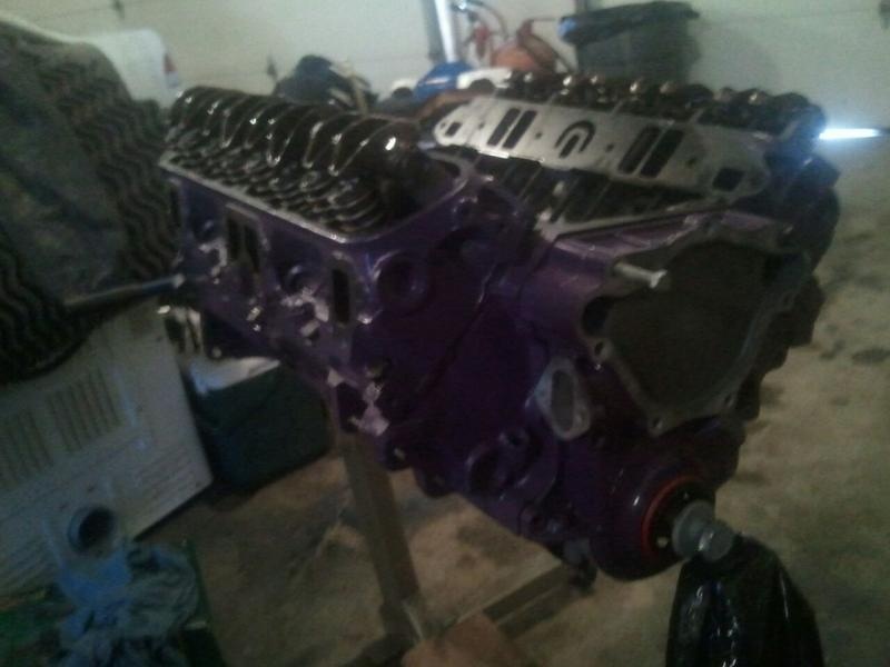

anyhow got my block and sparkly stuff from the machine guy
.30 over kb 107's and full comp cams valve train (20-222-3)
duration 262/270, Lift .462/.470 dual pattern, trick flow pushrods n springs n what not
clevite bearings are in a box on the way and i cannot wait to start
looking for any tips? secret hp adders? i know some of you have a few haha

update, well not really an update ben pretty lazy with my motor. my silly engine stand only has 3 arms to hold to the motor, so i need to make one more so it doesnt fall off when i put the 500 pound heads on

well update and all is good. finally riped out the 318 after realizing the starter and a little dirt shield needed to come off
360's ready just need torque converter flex plate n a bunch of miscellaneous stuff, lucked out on the fuel pump looks new
goin to germany in october so november that monster is goin in!!
update... ready to go in!! looks sexy :prayer:
