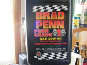

I,m running the Brad Penn 20W-50,it,s partial synthetic with zinc additives for antiwear protection for flat tapped or roller type cams.

I have a friend that is a sales rep for a local oil company (they refine and package oil and oil products) He ran some Brad Penn through his lab and wasn't too impressed. Not much zinc and it contained contaminants including water.
They have racing oils that contain zinc but they are 50wt or 20/50 which is too thick for a normal street engine unless you build it loose and with a big oil pump.
