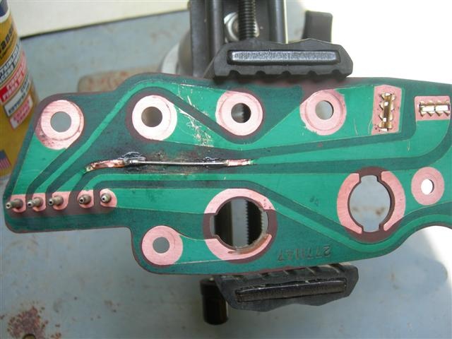

ugh just found out when i went to put the volt regulator in that there is a break in the printed circuit board near the volt regulator. should i solder it or just get a new cluster or printed board.
You can repair broken traces easily. Cut out the damaged area with a razor knife. Apply some soldering flux, then with a small low temp iron, place a small drop of solder on the trace. Cut a lead off a resistor to bridge the gap, then solder it on. Resistor leads work perfect because they are already tinned and solder easily.
turns out the in dash regulator around here is 37 at auto zone and 54 at napa.
Sorry, I was thinking of the one under the hood when you said "electro-mechanical". The 5V Vreg on the dash cluster is expensive, if you get a factory mechanical type. Many people install an electronic one, which is less expensive and much better. I got one on ebay for ~$25, also check IVR. Not like the original, it is a small circuit board you velcro to the cluster.
I agree that fixing traces on these boards is easy. These are old, hand-drawn one-sided wiring boards with wide traces, nothing like fixing a computer motherboard. You can get replacement boards for many models, but ~$100 and a lot of work resoldering components. No need for that since most are repairable.
