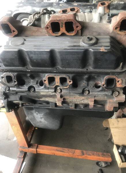

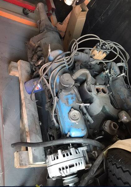

65 dart gt with a slant 6 auto on floor. Looking to swap in a v8. I found these two locally. First one says it’s a 318 out of a 70 charger with a 4 speed automatic trans. Engine and trans ran and shifted well when pulled. Comes with carburetor. What 4 speed trans does it look like and what would the fit be like in my 65?

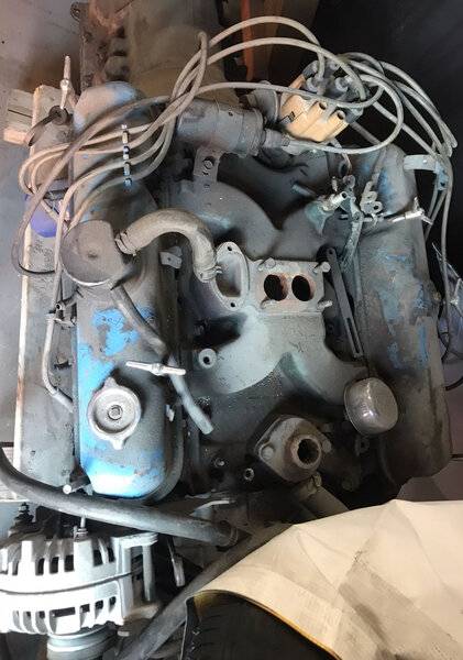

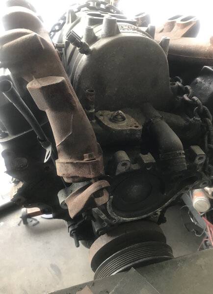

Second engine is a 1999 5.2 magnum. 108k miles. Regular oil changes. Owner swapped in a 360 magnum in its place. Ran well when pulled.
how do these look to you and which would you go for, if any? The 1970 is 700 bucks total and the magnum is 400

1st picture not a 4speed but probably a 904 auto, blue valve cover motor
Good catch, I thought it was a funny looking manual trans, but since I don't have one...
Dip stick tube...

318:
Comes with the transmission (that's a 3 speed 904 Torqueflite, by the way), torque convertor, and all linkages.
Correct oil pan.
Direct bolt up to 273 engine mounts and brackets.
You will still need a '70 and up radiator, a '66 Dart driveshaft (6 or 8, both used a 904. You need the slip yoke and correct length of the '66 shaft to replace your current ball and trunnion shaft), an early A V8 throttle pedal, V8 centerlink, and 273 (possibly others, many threads about that) exhaust manifolds or headers, and a '66/'67 speedometer cable. Possibly other stuff depending if you have power steering, etc.
5.2:
I love Magnums, but you'll need a lot to make it work.
A transmission, torque convertor, driveshaft, speedo, LA360 passenger car oil pan/pickup/dipstick & tube, intake manifold and carb, all linkages, distributor, appropriate radiator, and all the missing serpentine front drive components and accessories, modified 273 mount brackets to fit the Magnum, and the V8 centerlink.
And both are going to require you to seriously consider brake and suspension upgrades, possibly a rear end upgrade down the road as well.
My vote goes to the 318 at this point.

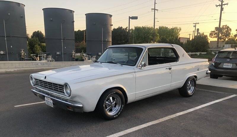

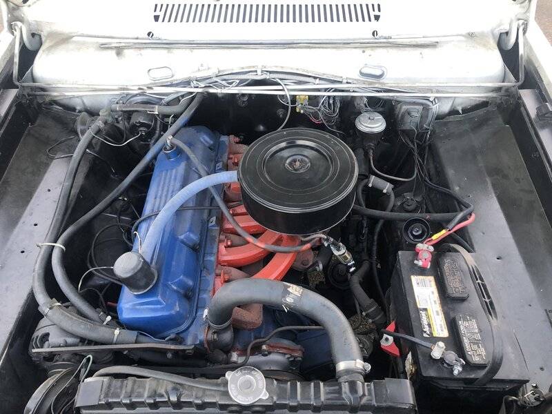

Currently I have the slant 6 225. It runs great and smooth and shifts the same. I want a lot more power, I want the sound of the v8. I was thinking of buying the 1970 318 with the trans, adding a 4 barrel intake and carb and upgrading the cam. Kinda hard to tear into the car when it works so well as is. Here’s what I’m working with, just bought it a few weeks ago
Great looking car. I like your idea with the 318. Get the 273 radiator, exhaust manifolds, and Charger exhaust system. Also see posts # 2 and 5. A & A transmissions may have a way to adapt the newer transmission to your factory shifter.
