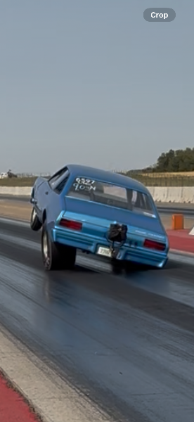

Hitting tire to hard? Video added

I went from 8.5 -9 psi and it didn’t change. I wanted to try 9.5 but then this happened and ended the season. Bent the ladder bar bracket.
