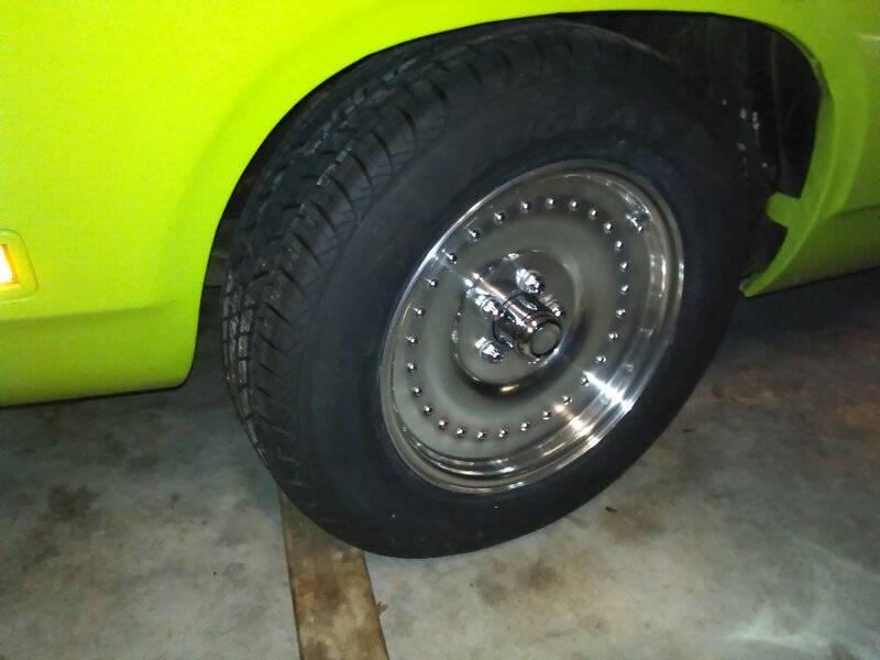

Tire hitting fender

I run 25.4" height compared to your 25.85 and width at 205(8.07")vs your 215(8.46") so your .225" higher and .195" wider at relative off set. How much are you hitting by? If you braced the fender outword would it clear then? And is the well trim straight and tight to the fender? And I agree is the BIG picture of life things could be worst. This is one of those "stomach turning" events that will pass.
The tire that's rubbing is close to an inch more forward from rear wheel center line to front wheel centerline 108 and 3/16ths on passenger and 107 and 3/4 on the drivers side plus the passenger side is in the wheel well more

You might want to try 205's go to a 60 and not a 70, a different backspace wheel or adjust your torsion bars different.

Do you or can you snap some photos of your front wheels and the wheel opening nad turn the wheel to where it rubs and post a few shots of that. From your avatar from what we can see it does look like the combination of your tire size and the width and offset of the wheel are a problem.

Hate do be a spoiler but if your wheels were a inch narrower or less backspace they probably would clear. Have you measured the car side to side? From the top of the wheel opening to the pavement? And it's rubbing on the front of the fender correct? More caster (the top of the wheel adjusted rearward) would open that gap as well.
I dont think you can get a half inch with caster do you?
