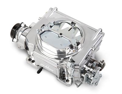

If you still aren't happy, after trying that Holley you bought, get a 670 Street Avenger, and give it a go. I'll bet you will be very pleased. It would be perfect for your combo(which is similar to mine, but I have a single plane intake)
Street Demon
