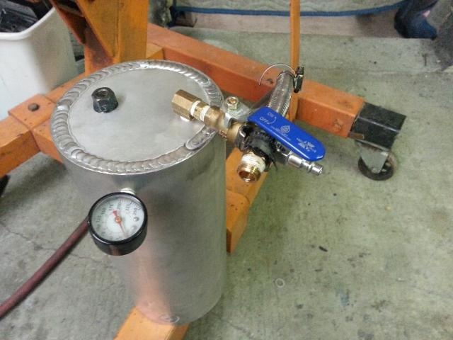

Yes the bottom port is directly from the pump and the top port goes directly into the motor to feed the bearings,My engine builder made a pressurized tank out of a old propane bottle with a filter on it and primed my motor and pump at the same time,-Steve

This is how I did mine, adapted a scuba tank to pump in the oil (any sort of tank would work, old fire extinguisher for example) air get's fed in at the fitting at the side, the top fitting has a pickup tube welded into it wich reaches all the way to the bottom of the tank (about 1" of the bottom). Air pushes down on the oil, only way it can go out is through the pick up tube and into the motor. Only drawback is that you have to fill it through the top fitting wich takes a long time, if I ever need this thing again I'll drill a 2" hole in it weld a piece of threaded pipe on it and use a cap.

Today on PowerBlockTV they primed a new style 4.6 distributorless engine using a tank filled with oil that was pushed with 60lbs of air pressure through a oil sensor port on the block. Showed oil pressure on the guage as the oil got passed through the engine. Look at the video around the 8 minute mark.

i just primed my motor tonight,, it worked awesome,, i made this tank the other day at work
